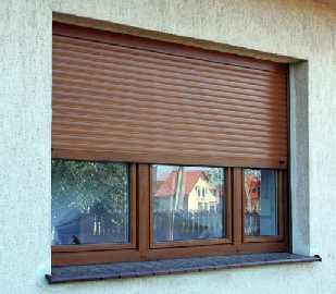

Milambar
25 Aug 2013 16:07
Insulated aluminum louvers
Exterior window with brown roller shutter, facade elements, and neighboring houses in view
chrizzt
25 Aug 2013 16:11
Then the price including the motor is fair
