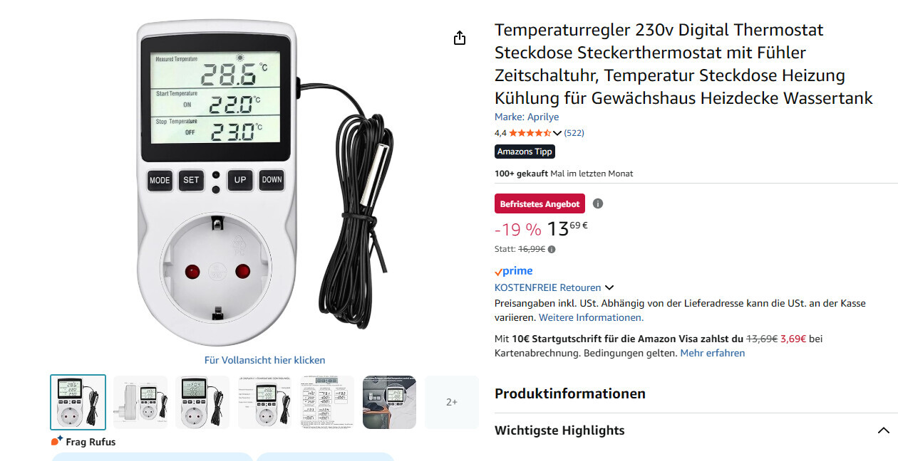

nordanney20 Dec 2025 12:08kurti2025 schrieb:
That's right, that's a good idea. So, using a mechanical timer switch to heat for 2 hours, then pause for 2 hours, and so on. No. This is what I mean (just an example). You set the temperature at which heating should start and stop, as well as how long the heating should last as an alternative (cycle mode).
wiltshire21 Dec 2025 09:46Take a look at socket thermostats. There are also very simple ones with a rotary dial to set the switching temperature and an on-off switch. This helps minimize installation errors.
