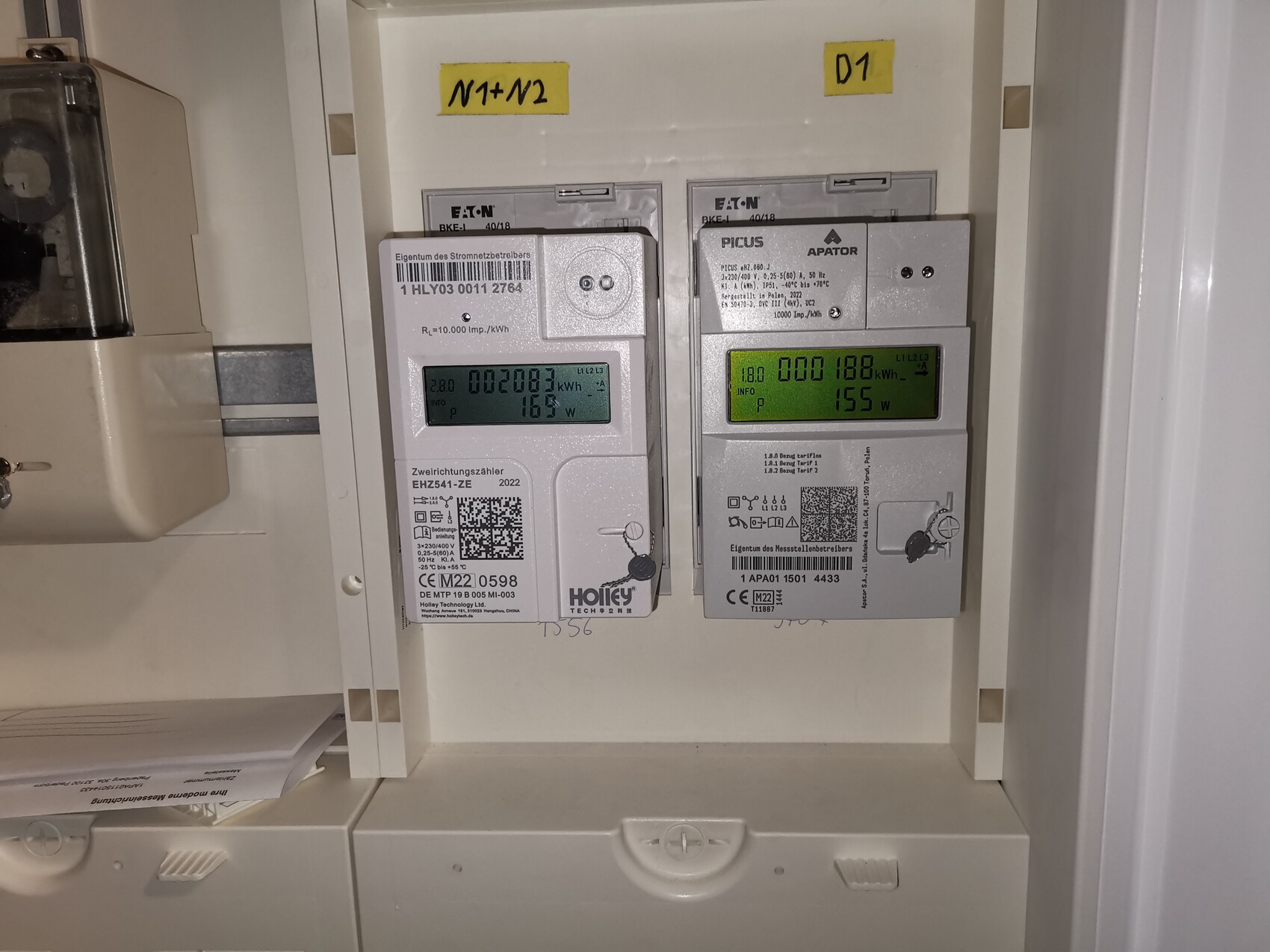

Hello, I am wondering which value I can read from the second meter "D1."
The first bidirectional meter shows me the electricity I draw from the grid and the electricity I feed back.

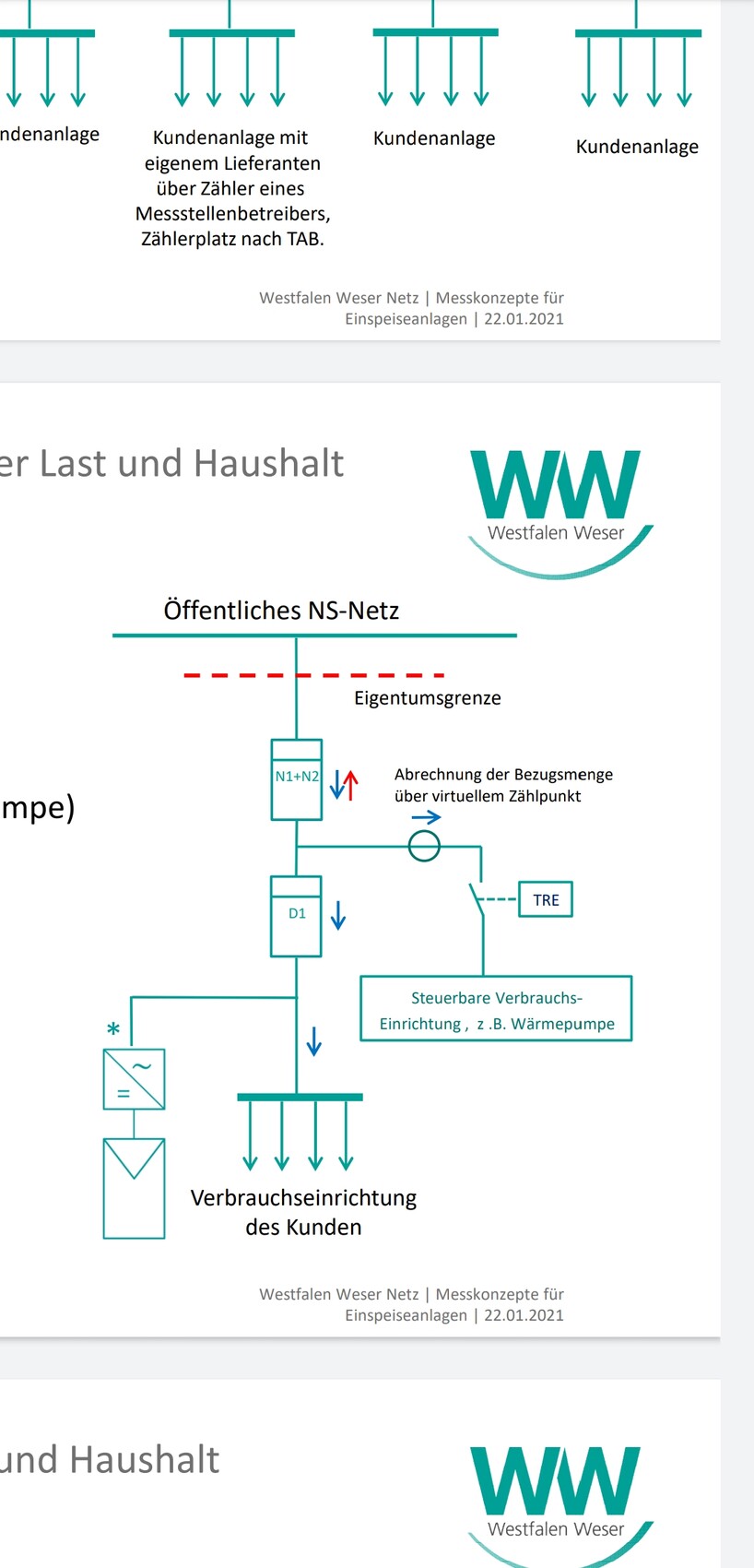

At first, I assumed that the meter on the right indicates the electricity I use from the photovoltaic system itself. According to measurement concept 4 (wwn), it rather seems that it shows the electricity I draw from the grid minus the electricity used for the heat pump.
