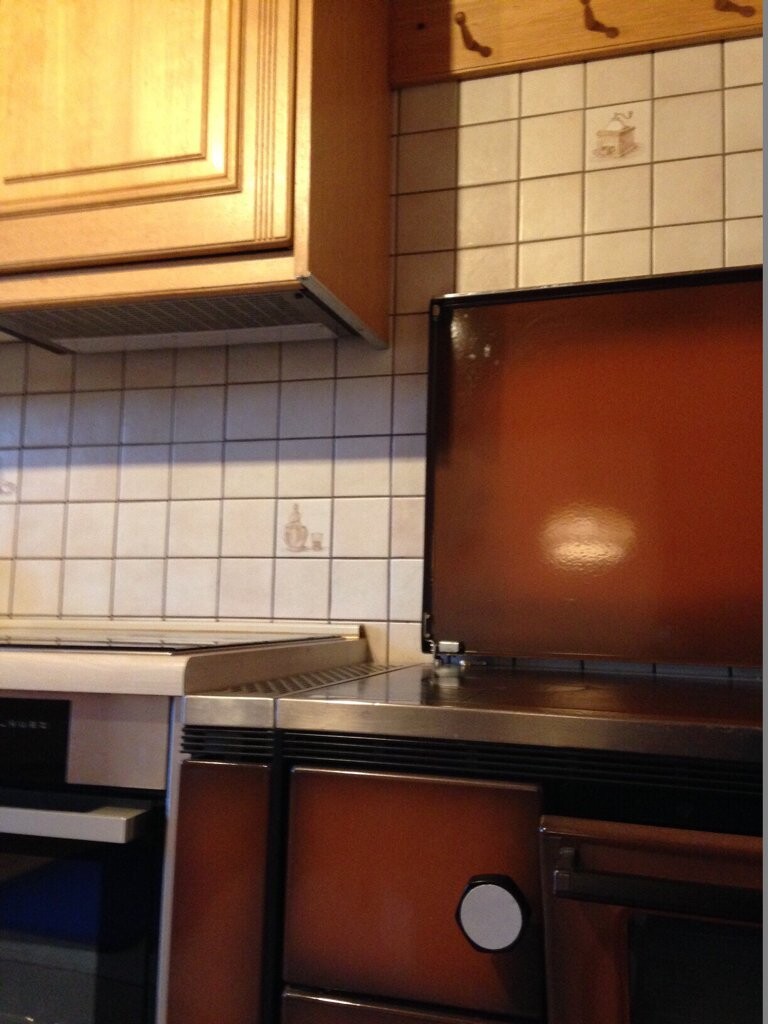

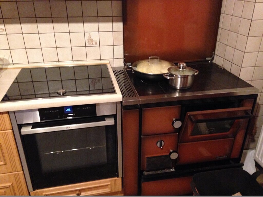

Bau-Schmidt14 Nov 2017 22:54I don’t see any pictures.
Hanse, unfortunately, I can’t see the pictures either. But the dimension you gave for the wall cabinets is very helpful. I redesigned the kitchen yesterday; now all the wall cabinets will be placed on the opposite wall.
After carefully measuring the chimney connection, the layout for the "stove row" is now set: an 80cm (31.5 inch) base cabinet, then the stove (I changed my mind - it will be either a Wamsler W1-90 or W2-90), followed by another 80cm (31.5 inch) base cabinet, next to it a 60cm (23.6 inch) tall cabinet with oven and microwave, and finally another 60cm (23.6 inch) tall cabinet. This means there will be 80cm (31.5 inch) of free space “above” on both sides of the stove.
