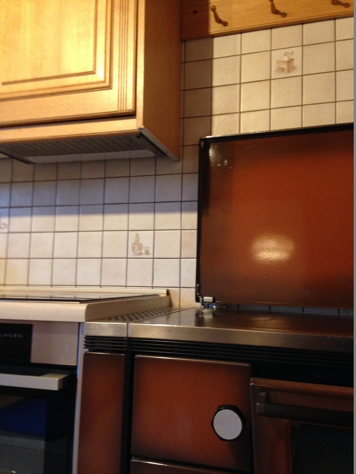

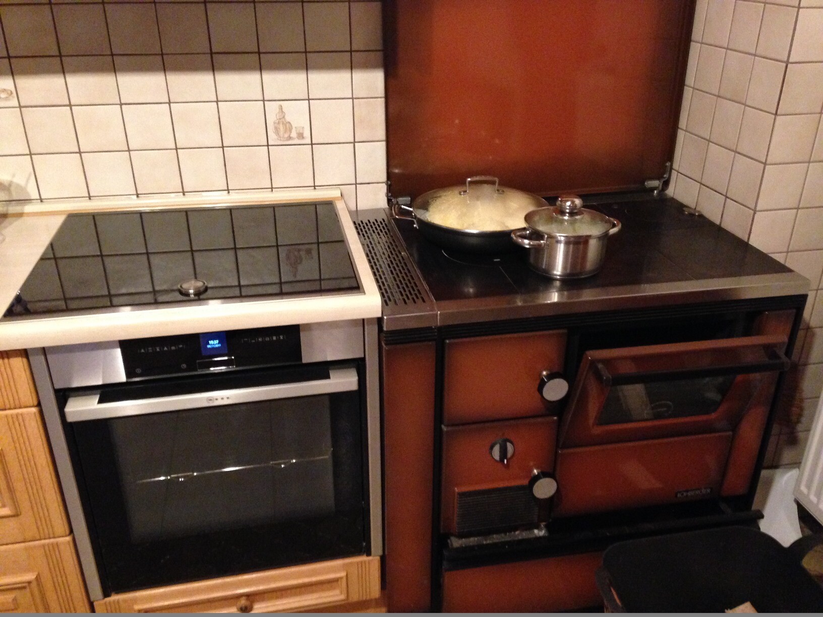

Bau-Schmidt12 Nov 2017 11:50Have you ever considered the safety clearances around the stove?
Here are the pictures. (Unfortunately, the area is not tidy)
You can see the spacer between the electric stove and the wood-burning stove. The spacer has shielding plates on the inside. In the other picture, there is a veneered panel on the side of the wall cabinet. This panel caused us the most problems. The cabinet fronts did not, as they are made of solid birch.
If possible, I would keep at least one cabinet width (60cm [24 inches]) of distance between the wall cabinet and the wood-burning stove.
