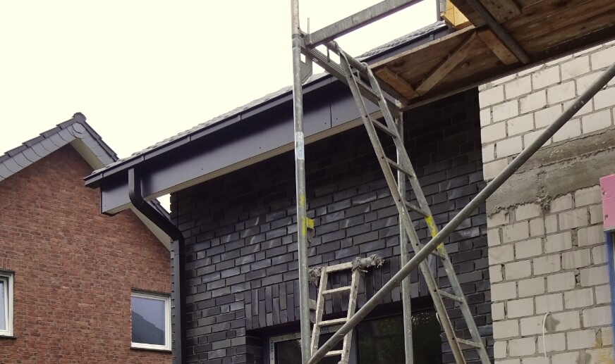

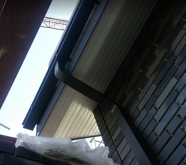

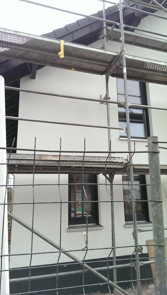

Sebastian7922 Oct 2015 11:35This was a loooong topic for us – painted wood was initially favored because of maintenance. Having to repaint every 3-4 years is a bit too frequent, but you definitely need to repaint at least every 8-10 years if you want the wood to last. This means expensive scaffolding again, sanding, and multiple coats of paint. Personally, I wouldn’t feel like doing that...
Then we considered aluminum beech as eaves cladding – but later it was discouraged because it warps in heat.
Next was standing seam zinc sheet metal – I still think it looks nice, especially on a more modern house. But it is expensive (especially if done nicely, i.e., with vertical seams). I’m surprised to hear it is supposed to be cheaper or about the same price as wood.
In the end, for the eaves, we chose colored panels (anthracite) from Trespa. The verge trims themselves are made of white plastic – also for durability. And since we don’t like fascia boxes, we clad the roofslope’s edge instead.
On the extensions, we had anthracite-colored standing seam sheets installed on the sides, and we are very happy with how it looks.

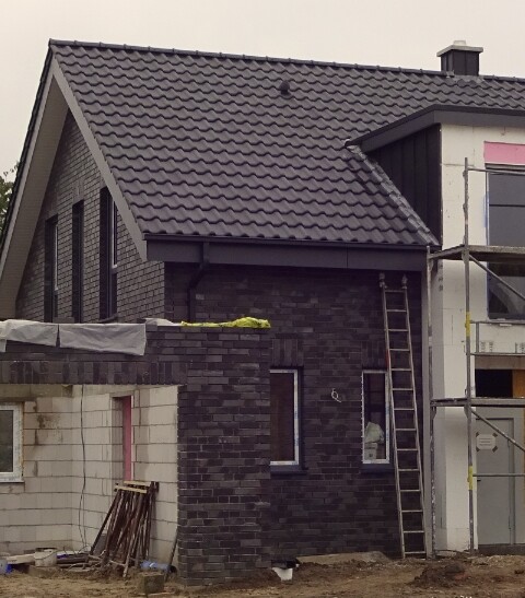

Bauexperte22 Oct 2015 11:53Here is another example of a bargeboard cladding. Additional costs for the single-family house were about €500 (I’m not exactly sure, as our clients negotiated directly with the roofer). The undersides were painted at no extra cost, based on the homeowners’ choice. Now the “cap” of the single-family house shines entirely in RAL 7016.
Best regards, Bauexperte
