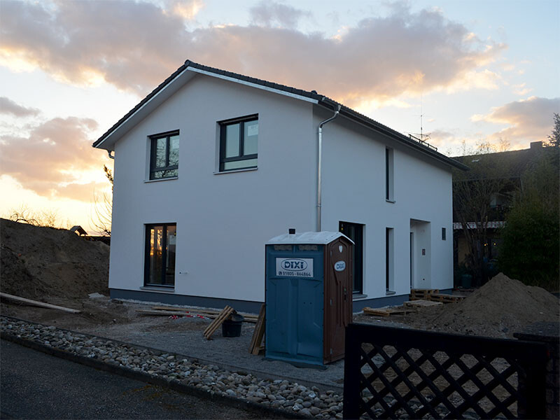

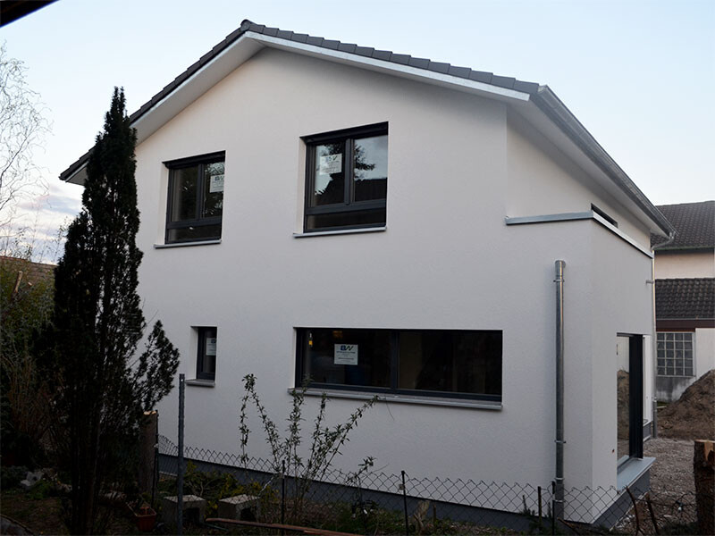

I am currently planning a gable roof with a 38° pitch. The eaves will have an overhang of 64cm (25 inches), and the gable overhang will be 36cm (14 inches). Previously, I had planned for a 87cm (34 inches) overhang at the gable, but my architect advised against this for aesthetic reasons (mushroom effect). Incidentally, I also saved 1,980 euros. However, I didn’t want to reduce the overhang any further, as I believe no or very small roof overhangs give the impression that someone was trying to save too much...

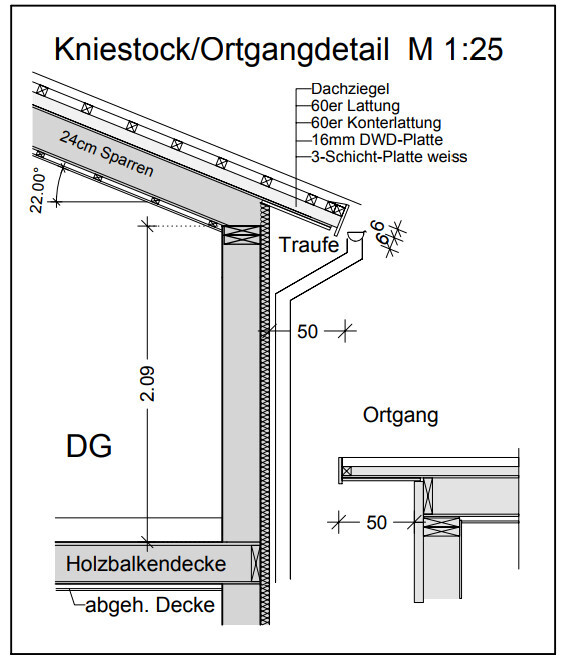

Changeling28 Nov 2017 06:46I have now found a solution online that I really like:
- Only reinforced battens, meaning no visible purlins where birds could nest
- Enclosed space directly under the roof
- 50cm (20 inches) all around
I have not seen this in any other house so far; usually, these "roof boxes" were very thick because of the large beams. Is this especially expensive or complex here? My planner never mentioned this option.
Is there a specific term for this type of construction?
