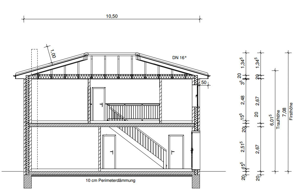

If I’m not mistaken, we have an eave height of 6.20m (20.3 ft) with two full stories, each having a ceiling height of 2.60m (8.5 ft) measured from the finished floor level.
So I don’t see why it wouldn’t work with 6m (19.7 ft). Maybe just with slightly lower ceiling heights.

Either we are talking about different things, or an eave height of 6 meters (20 feet) is absolutely not a problem. Here is our cross-section. The 1.5 cm (0.6 inches) is measurement inaccuracy.
Ceiling height of the upper floor measured at 250 cm (98 inches) from finished floor level (an Ikea Pax wardrobe fits in easily).
Better check the development plan to see if two full stories are even permitted.
