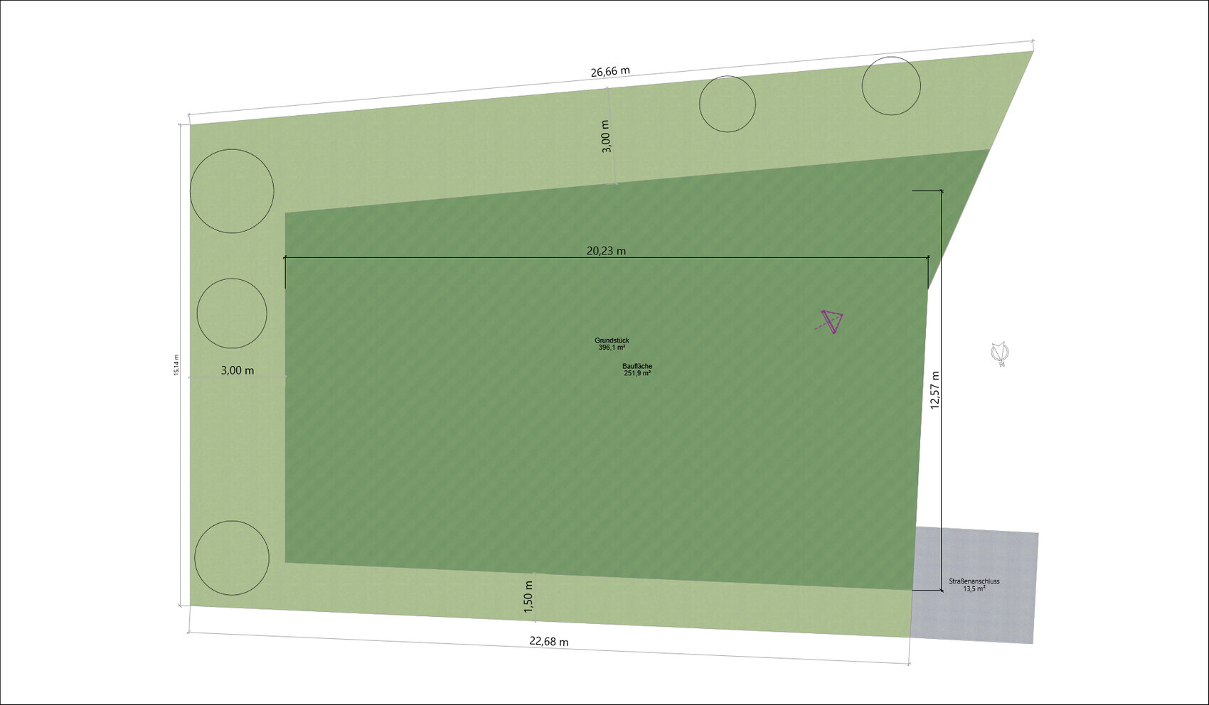

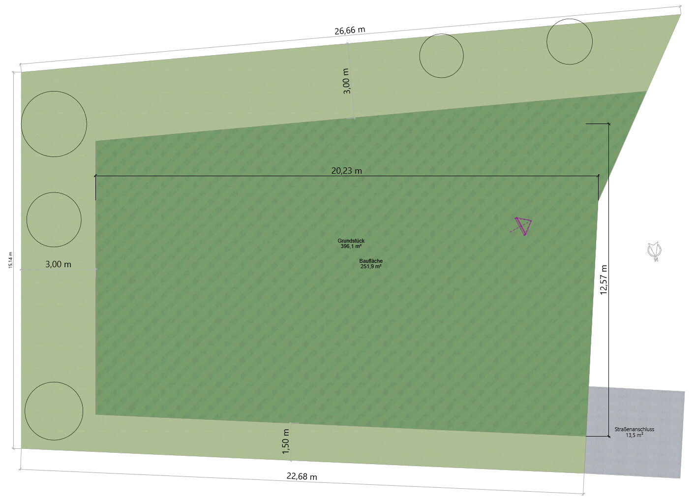

We have 400 sqm (4,300 sq ft) available in one of our dream locations. About 250 sqm (2,690 sq ft) can be built on within the building boundary. I tried to illustrate this:
The development plan states:
Floor area ratio = 0.4, gable roof mandatory
If I understand the eaves height correctly, the roof must sit almost directly on top of the floor ceiling at a story height of 2.5 m (8 ft 2 in) to reach an eaves height of 3.0 m (9 ft 10 in). There can’t be more than about 30 cm (12 in) of knee wall, right?
Does this still allow for a 1.5-story single-family house? We would actually prefer one of the typical modular house designs with a maximum footprint of 8 x 10 m (26 x 33 ft) (located close to the street access, with a large garden on the west side). But how does this work regarding the attic under these conditions?
What do you think?
Jens
