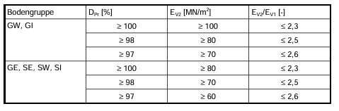

In my reports, I always require a resilient modulus (Ev2) of 80 MN/m² for single-family houses. In my opinion, this should be the minimum standard. We want to ensure that the installed material achieves a Proctor density of at least 97%. In our region, however, gravel (GW) is typically used, which usually allows values above 100 MN/m² without any problems. From what you describe, you seem to be building rather in the north with sand (SE, SW, SI).

Tabellarische Übersicht zu Bodengruppen, DPr und EV2 für Rohbau und Fundament.
What can help is thoroughly moistening the material again and compacting it once more. There should be at least 24 hours of "rest" between compaction and the plate load test.
Ideally, a static plate load test should also be performed to determine the modulus ratio (Ev2/Ev1). This indicates how well the material has been compacted and whether there is still "room for improvement" due to the material itself. Unfortunately, this test is often omitted because it is more complex and therefore more expensive... Alternatively, a Proctor test can be conducted, but that also incurs costs...

The "annoying" part about a static load plate test is that it requires a counterweight of at least 7.5 tons (7.5 metric tons), meaning you need an excavator or something similar. The test itself takes about half an hour. It’s definitely different from just dropping the plate three times...
Unfortunately, I don’t have a perfect solution to this problem, and I know every euro spent on building a house is painful and needed elsewhere.
I would try the approach described with watering and recompacting. With a well-graded sand (SE sand), 80 MN/m² (megapascals) is basically the upper limit. So, reaching 35 MN/m² with the dynamic test and calling it good should be fine.
