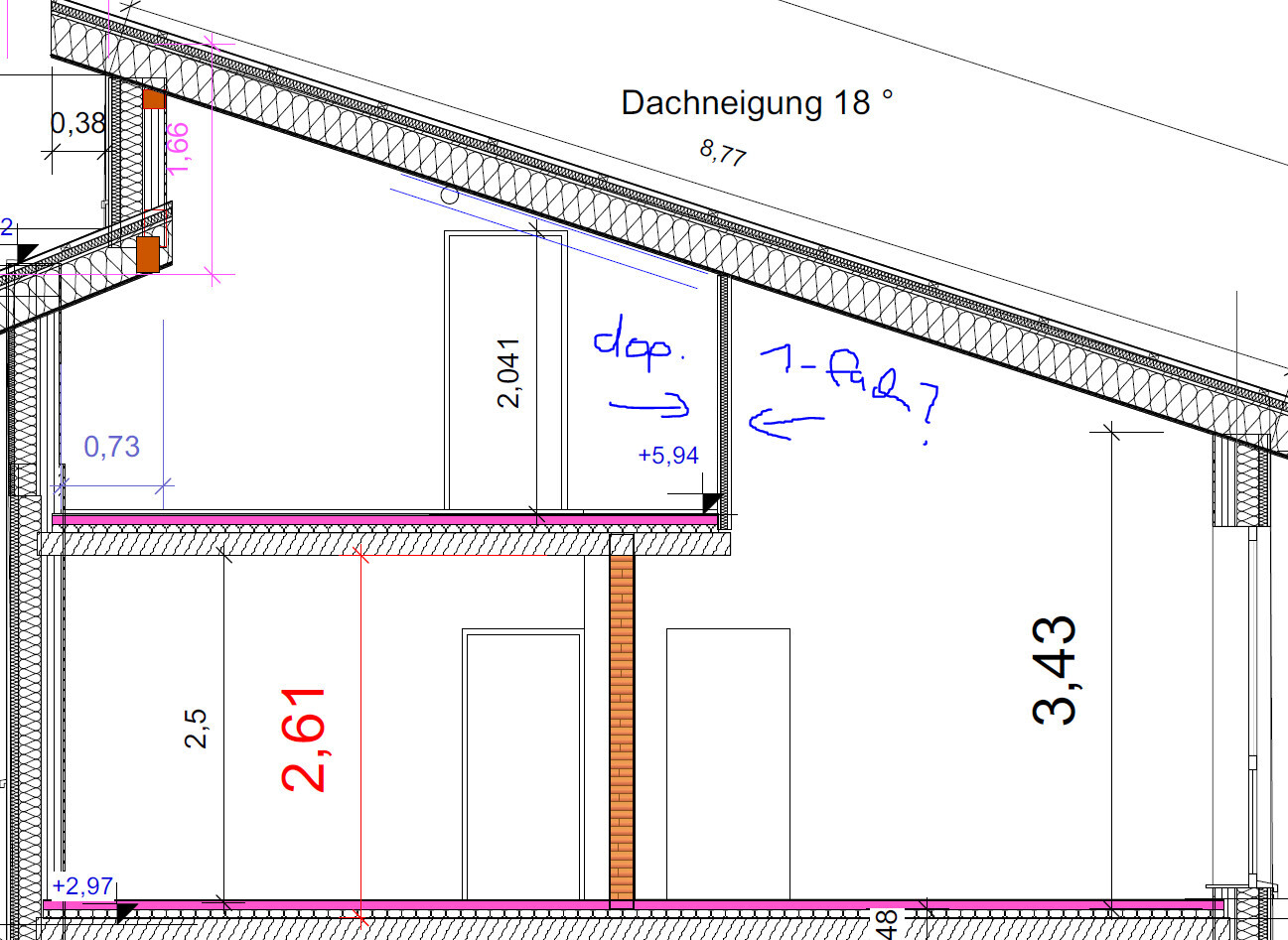

Thank you for the detailed explanation. Will only one side be double-layered with drywall, or both sides?
The one side (right) is definitely not load-bearing, and no one walks in front of it since it is suspended in the air, as shown in the picture:
Section through building with 18° roof pitch, interior space, dimensions, and wall panels.
Would you also add glass wool insulation with the double drywall?
One more question: I want to install a lightweight partition wall in the bathroom to support a wall-hung toilet. Is double drywall sufficient here? My architect suggested OSB boards, but is that really necessary?
hanse987
15 Aug 2021 14:24
Normally, both sides are always double-layered with sheathing.
If you want to build a great resonator, then leave out the mineral wool insulation! Why would you try to save on that? For example, Knauf does not provide insulation values for walls without mineral wool inserts in their datasheet, not without reason — the values are simply poor.
I find the joints (floor and ceiling connections) in your drawing interesting. Do you even have the possibility to properly attach the wall to the ceiling in the roof area? Depending on the construction, sound transmission could also be an issue there.
