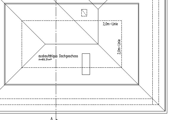

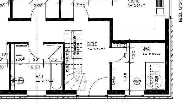

hauspeter16 Jan 2019 00:08Two images for clarification. On the ground floor, the staircase and the attic ladder are marked; on the upper floor, only the attic ladder is shown. The planned staircase is located between two beams and is approximately 3.5m (11.5 ft) long, positioned about 1m (3.3 ft) behind the 2m (6.6 ft) height line on the upper floor. I estimate the height to the roof is also around 3m (9.8 ft).
With the attic ladder, everything would have been nicely sealed. With the wooden staircase, we now have a 3m² (32 sq ft) hole in the ceiling that needs to be closed—from the exterior wall to the middle of the hallway.
