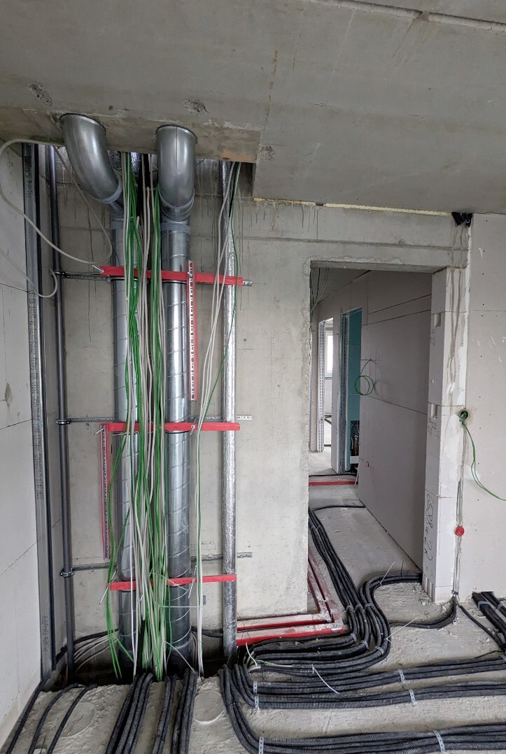

Here is a photo from the shell construction (not all cables have been installed yet, and the laundry chute is still missing)

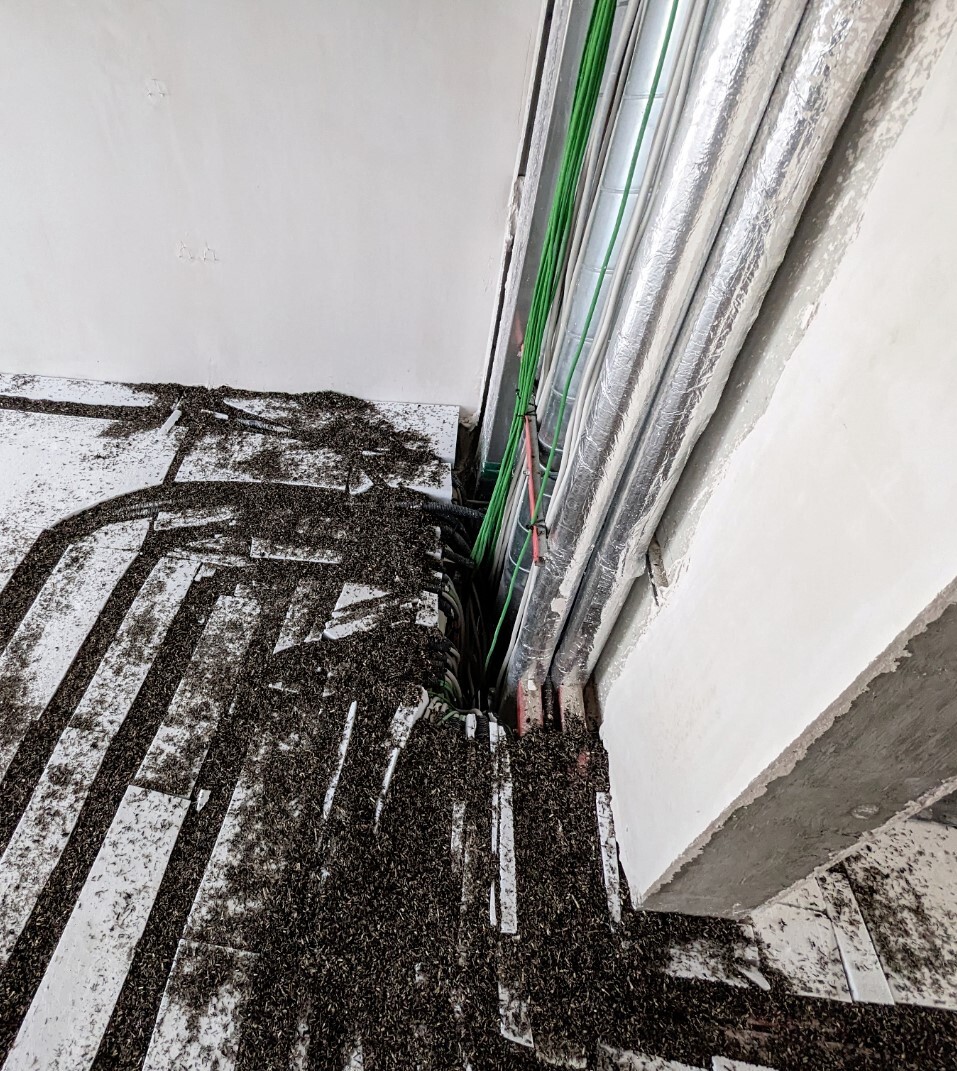

The shaft completely filled after installing the impact sound insulation (unfortunately, I don’t have a photo from a different angle)

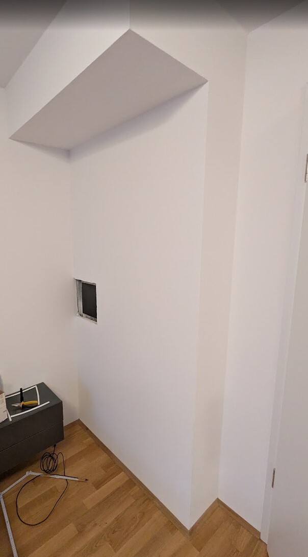

Finished drywall partition
Since the secondary wall cladding was positioned quite close to the shaft, the horizontal finishing profile was not anchored to the floor across its full width, but only at the locations of the vertical profiles. Unfortunately, I did not take any more pictures of this, otherwise it might be clearer now where the noise is coming from.
The sound seems to come roughly from the middle of the wall on the right half (as seen in the attached photo).
