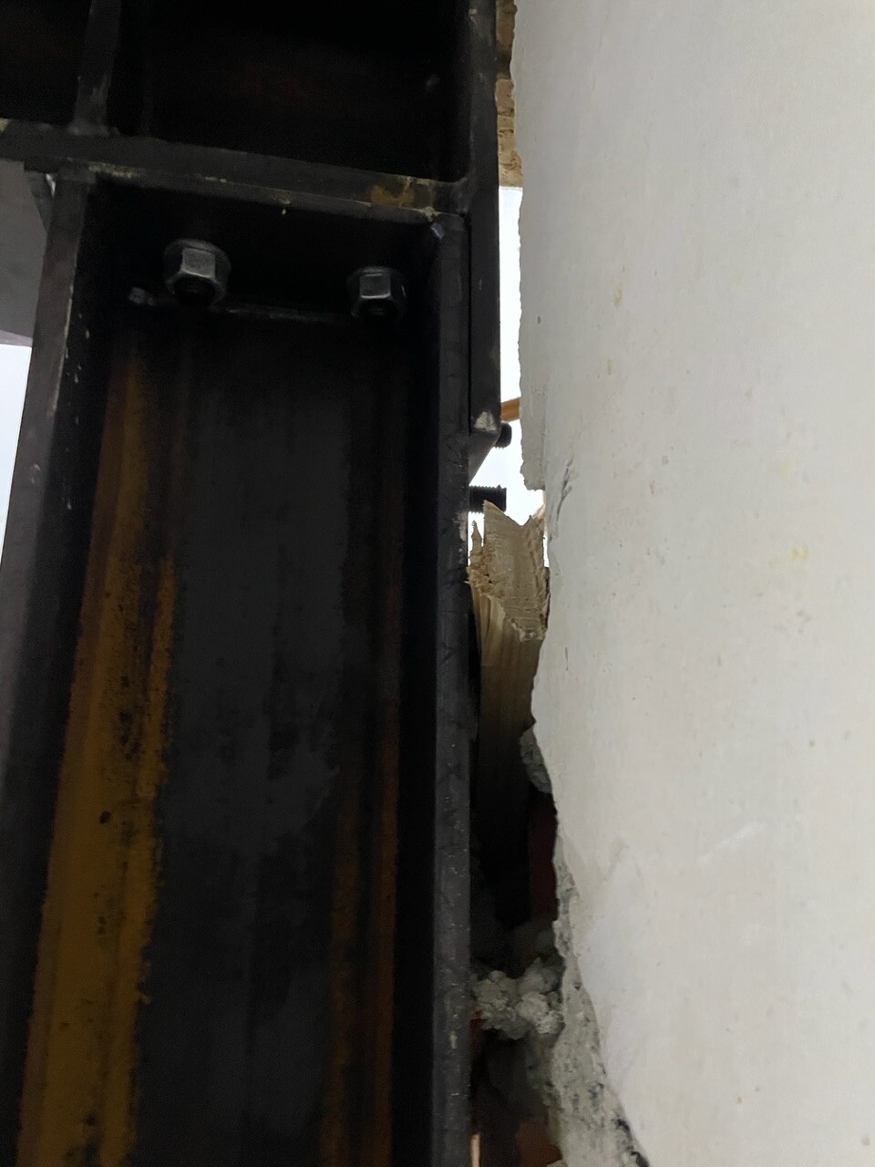

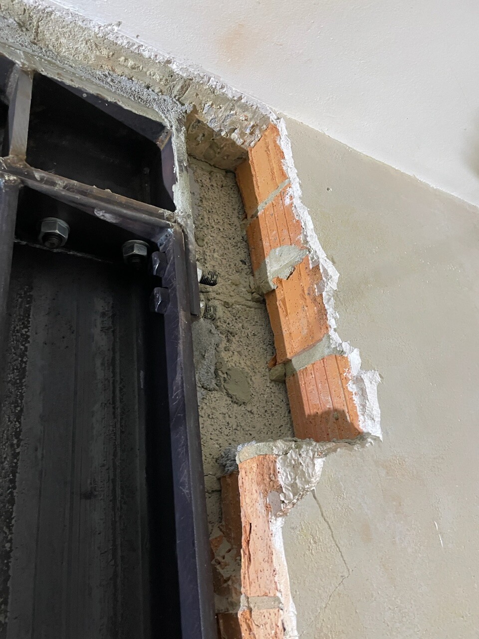

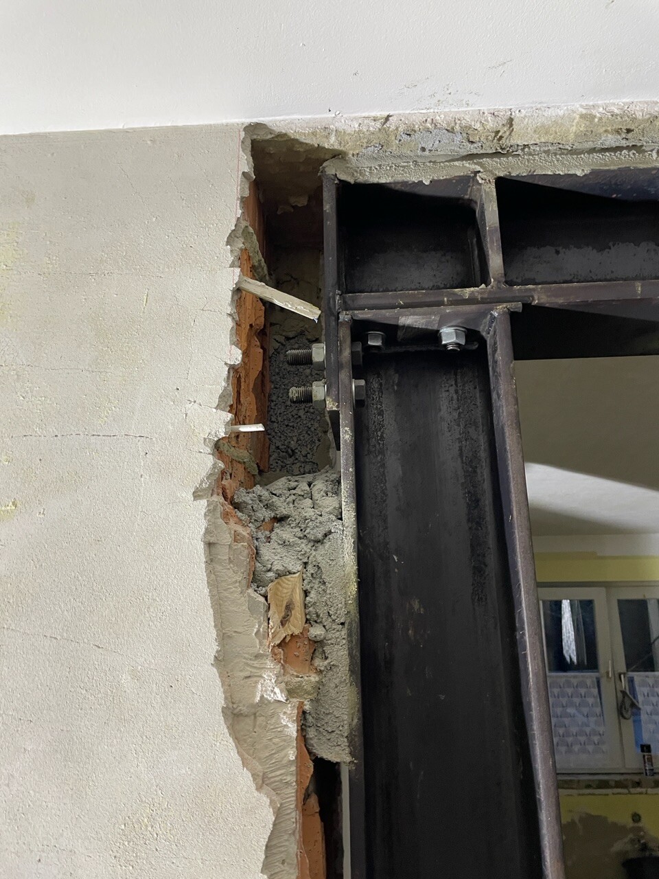

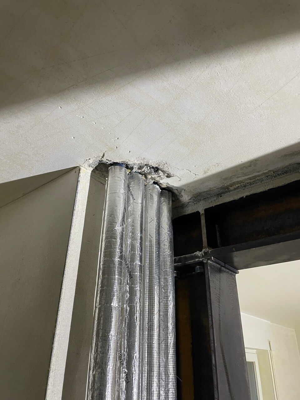

We want to leave the beam exposed spontaneously. However, the pipes must be concealed behind a wall. I want to finish the wall flush with both the wall and the beam. What is the best way/material to build the substructure for this? Should I fill the open gaps with PU foam? Or should I add mortar or bricks to the openings?

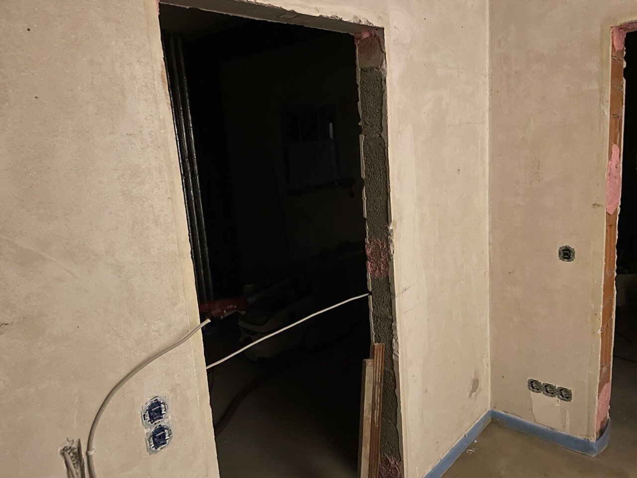

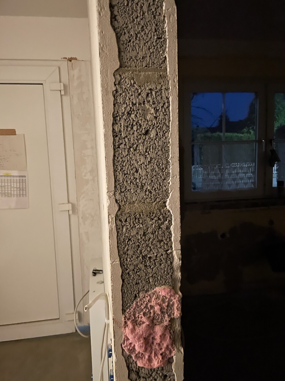

The same goes for the door opening. Here, I was thinking of simply using timber studs and then screwing the wall onto them.

14 Mar 2023 21:20
