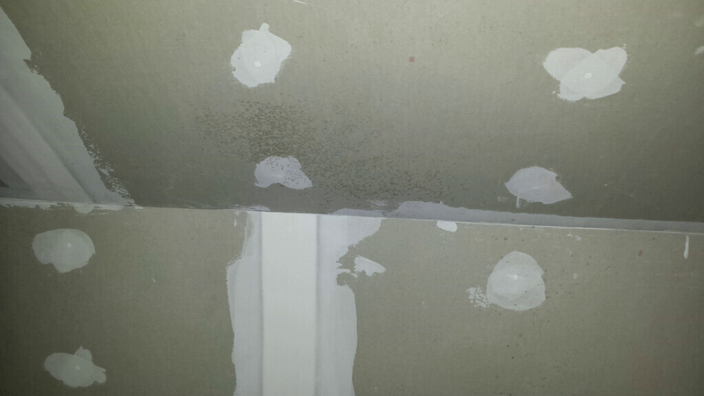

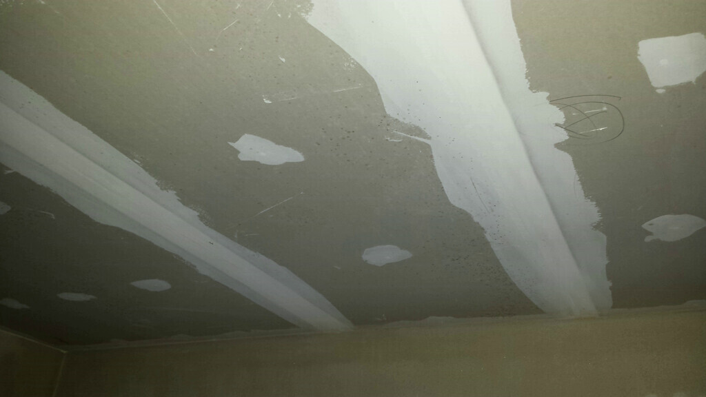

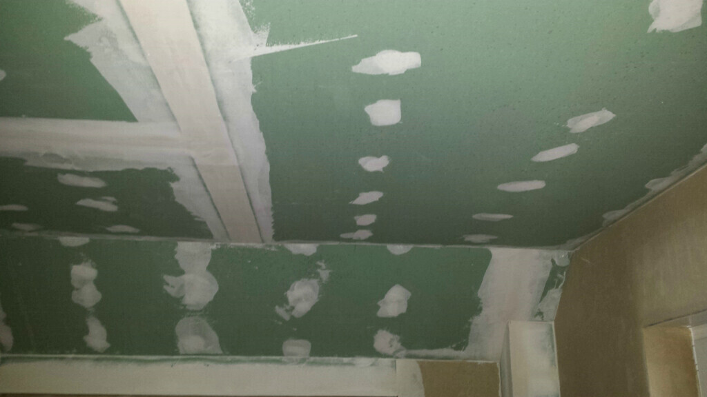

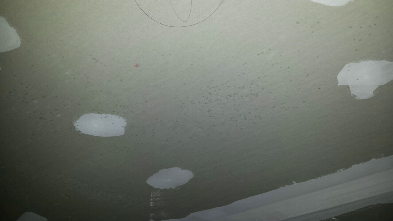

The cement screed has been installed for about three weeks now, and small black spots are gradually appearing on the drywall panels upstairs.

Is this mold? It looks like mold to me.

In our case, the drywall sheets were installed only after the heating-up phase. Moisture levels were measured several times beforehand.
There were mold spots on the battens in three rooms. These were completely replaced before the sheets were installed and taped.
Contact your site manager and clarify this on site.

I took the time to convert the images.
Incomplete ceiling with plaster spots and moisture marks
Raw ceiling with filler work and visible cables in interior construction
Green ceiling with white filler spots in interior construction at a building site
Shell construction ceiling with uneven plaster, loose cable hanging down, visible construction defect

In our case, it happened - I believe - simultaneously; I still remember the drywall installer telling us that the container of the construction dryer had leaked.
So: ventilate, ventilate, ventilate – and do it properly!
And it is certainly also weather-related: the moist air needs to be removed!
