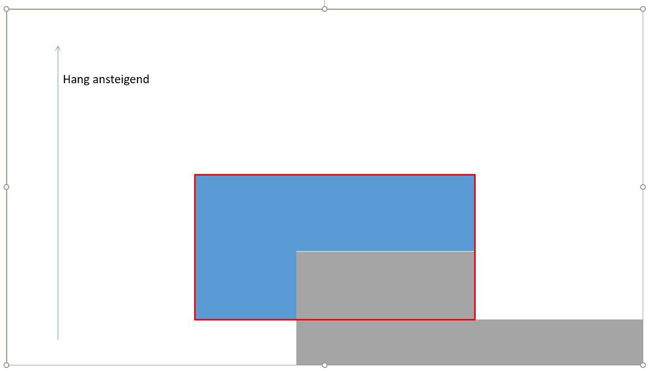

sichtbeton82 schrieb:
Attached is a picture for clarification. Gray represents the access path and parking space. Blue is the basement in an L-shape. Red outlines the ground floor and upper floor.
The house sounds interesting, but it probably wasn’t exactly inexpensive.
Unfortunately, we are not allowed to add another story below the house; otherwise, that would definitely be an option. But maybe we can do a staggered design, like in Escroda’s suggestion. There wouldn’t be any objections to that.
We will show the plans to the landscape gardener and architect to get their opinions! I will keep you updated.
