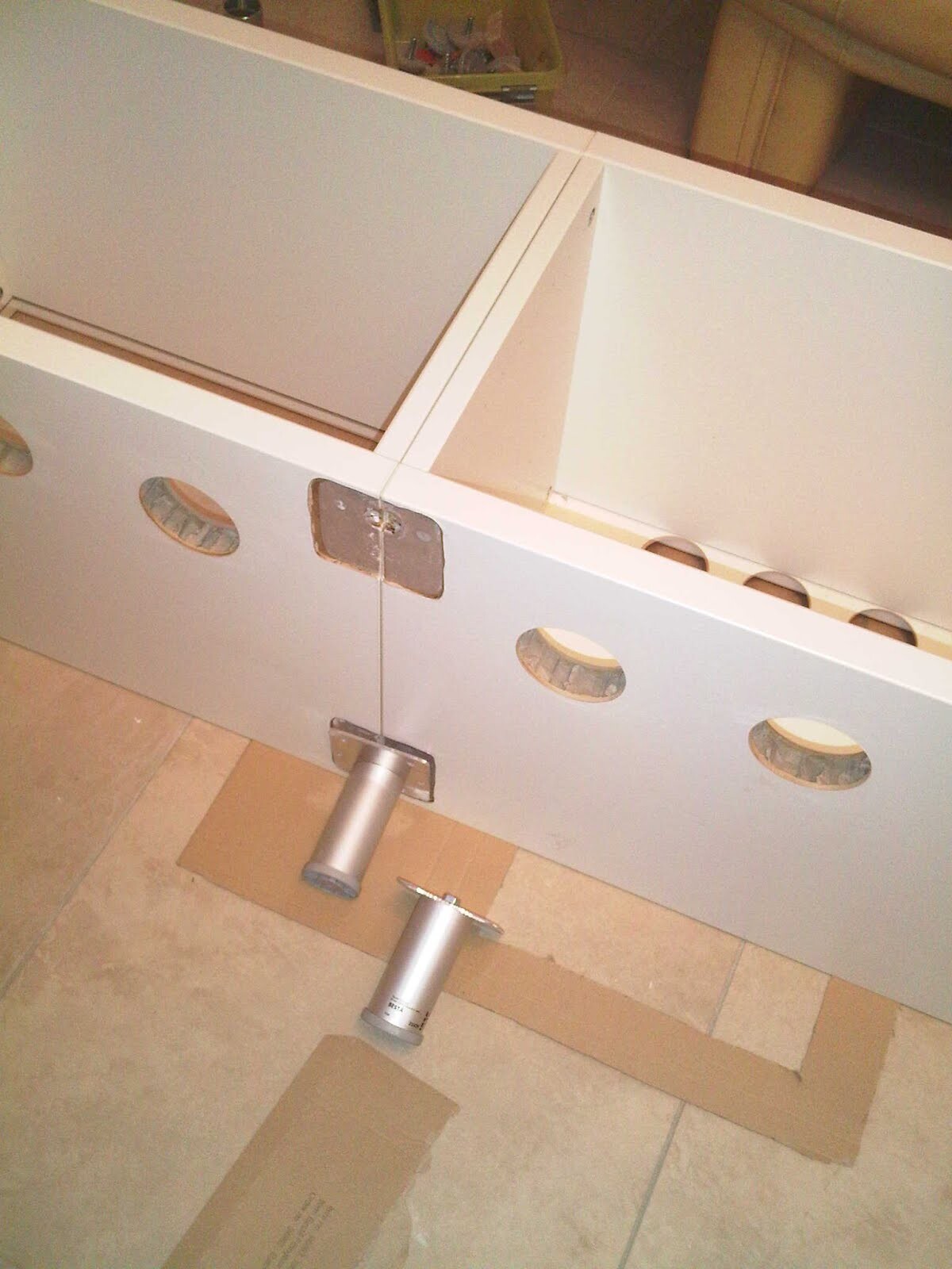

It might tear, break through, or something similar. I just found a picture – the hole looks neat. Maybe I’ll try that too sometime.
White furniture frame with round cutouts in the side panel; metal fittings lying on the floor.

If you drill from both sides, nothing will break out. So, only drill halfway through, then finish the rest from the backside.
However, this only works with a hole saw with a pilot drill bit.

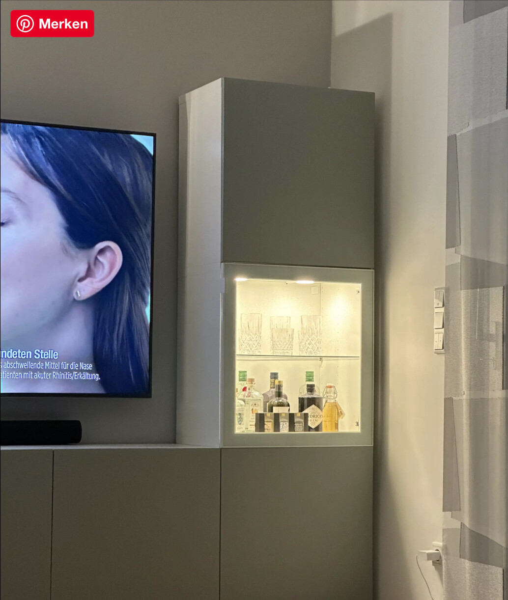

Of course, I destroyed the lid while trying to mill a hole in it. I'm just not cut out for such delicate work on this cardboard-like material – but the extension is still in place, including the lighting, whose cables wouldn’t have been visible anyway since the display case is so deep.

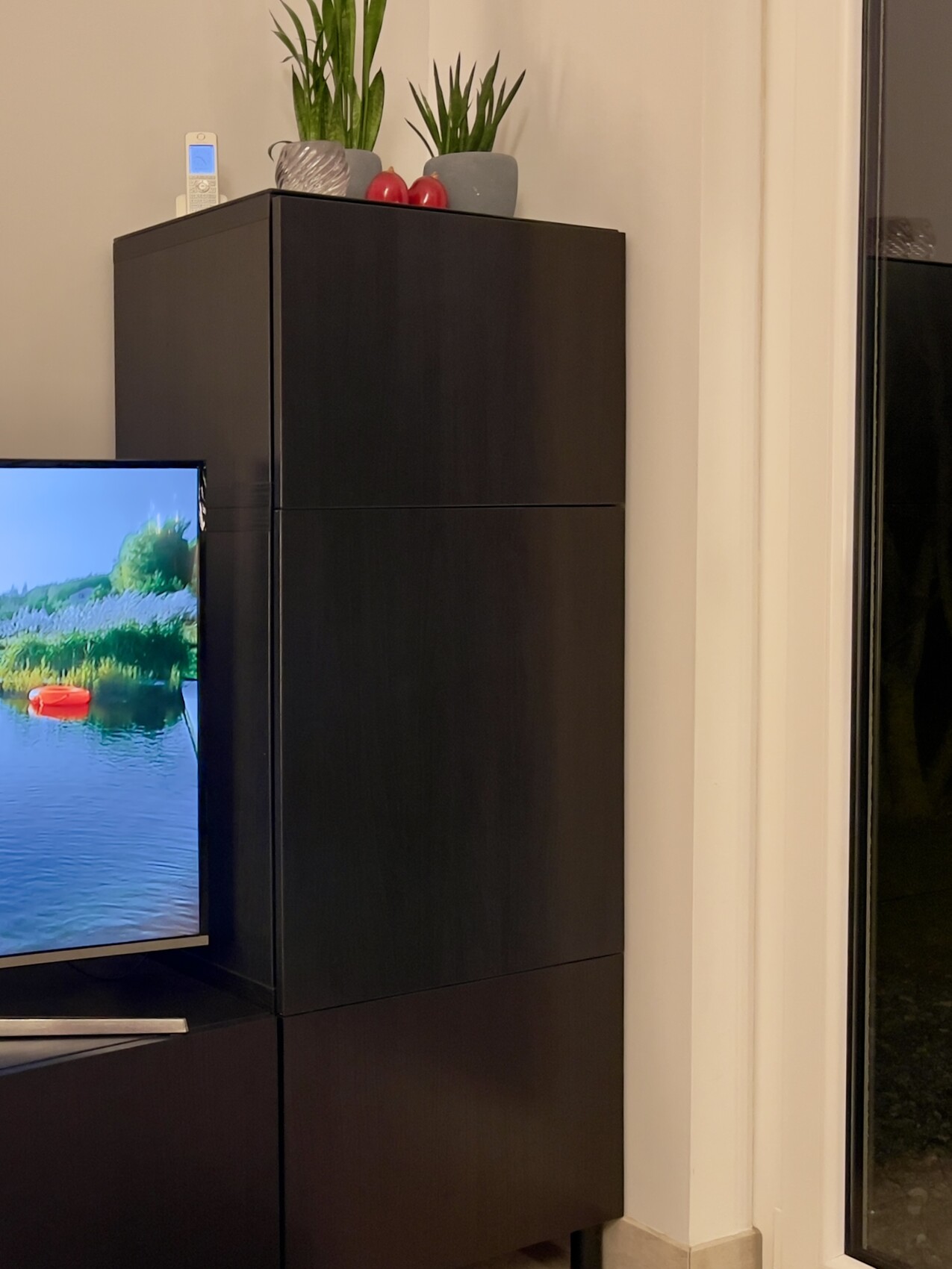

Funny… very old BESTA furniture… light gray wall, and I’m considering painting the cabinets gray/taupe…
Modern living space with gray cabinet, glass display case with bottles and TV.
Dark TV cabinet in the living room, TV on the left, plants and red apples on top; window on the right.
