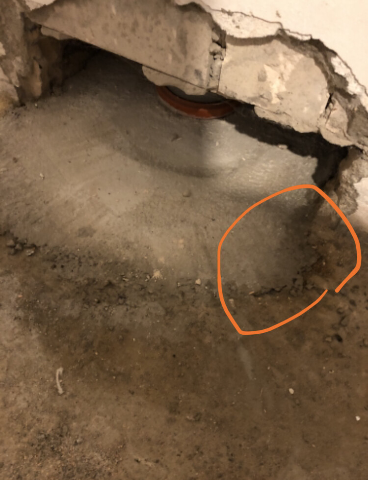

I need your collective expertise again. In my basement, the roof drainage passes through the concrete slab into the sewer system. About a year ago, I replaced the 90-degree elbow because it was damaged. Now, groundwater is seeping between the old concrete and the new concrete into the basement.
How can I make the concrete connection to the old slab waterproof against water pressure? I was thinking of first filling 25% of the hole with fast-setting concrete, then pouring in bitumen and letting it harden, and finally filling the rest with regular concrete.

Strahleman25 Jul 2021 13:12If there is hydrostatic pressure, I would recommend hiring a professional company. They will seal the leaking spot using epoxy.
BBaumeister27 Jul 2021 09:04I would also recommend hiring a professional company, but if you definitely want to do it yourself:
I would start by applying a waterproof slurry. Otherwise, moisture could penetrate the concrete slab through the fast-setting concrete. So first the waterproof slurry, mixed quite thickly. Once that has cured, I would apply an acrylic sealant around the pipe. I would then fill the remaining space with waterproof concrete (WU concrete), although honestly, I’m not sure what it is made of. Will the space remain a usable basement?

BBaumeister28 Jul 2021 14:41In that case, I would definitely hire a professional company. If moisture still rises at the end, your tiles will come loose. That would be a false economy.
