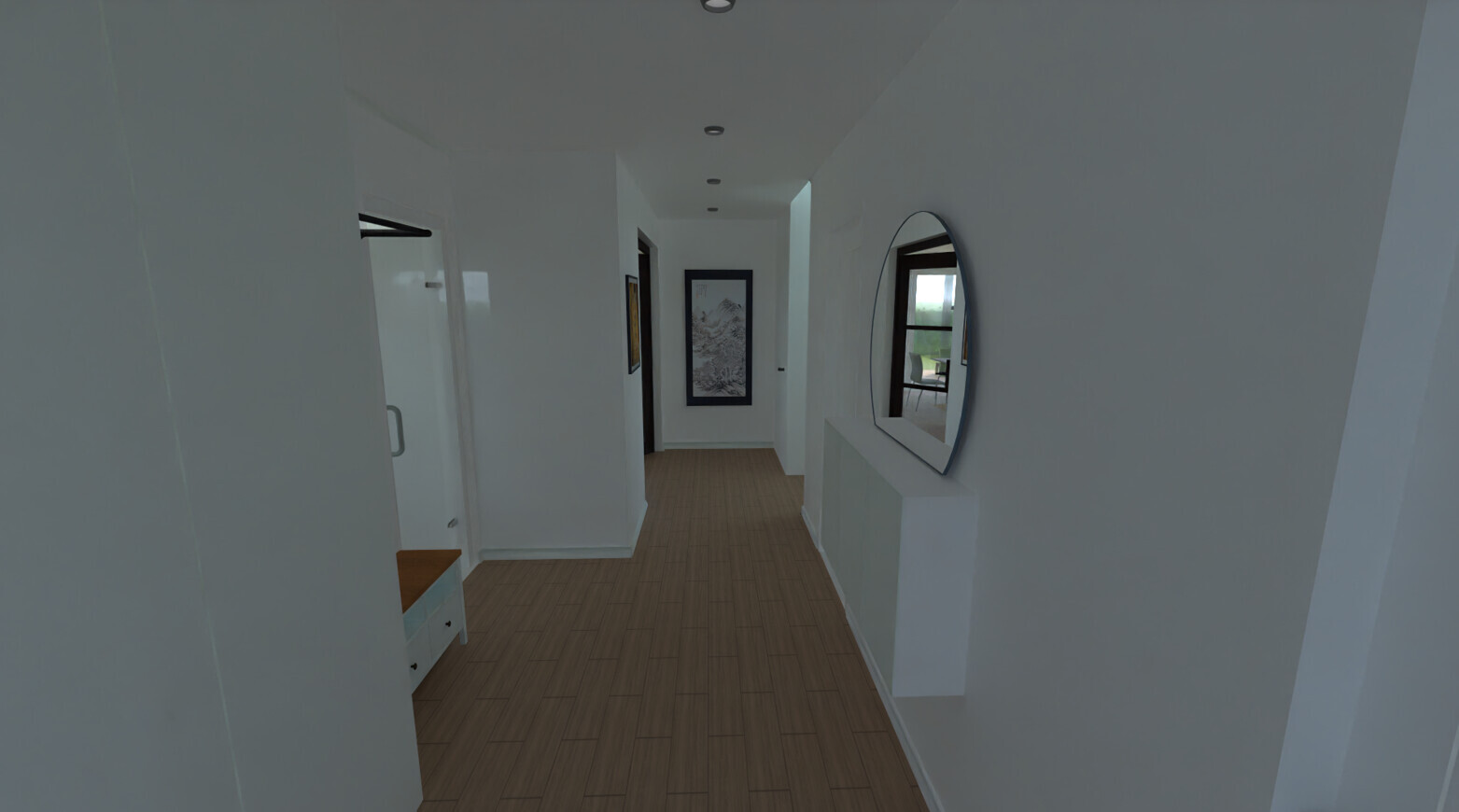

I gave my computer another 5 minutes to process for you and tripled the light intensity.
First of all, I think it’s good that you visualized it. This can help prevent some disappointment. Increasing the brightness on the screen, however, doesn’t help you much in reality. Yvonne already explained it well. This hallway doesn’t lead visitors into the living area but narrows down to an unpleasant bottleneck. Instead of opening up into the living room, you end up among dirty pots and pans or blocking the cook.

What do YOU find uncomfortable for YOURSELF? Well, my dealbreaker is the hallway. The narrowing before the stairs looks awful right when you enter. It doesn’t guide you anywhere. On the contrary, doors and pathways remain hidden. Then the turn into the kitchen is, in my opinion, a design mistake aesthetically. The tight space at the stair landing is also problematic. Anyone coming down the stairs with momentum risks hitting the wall.
