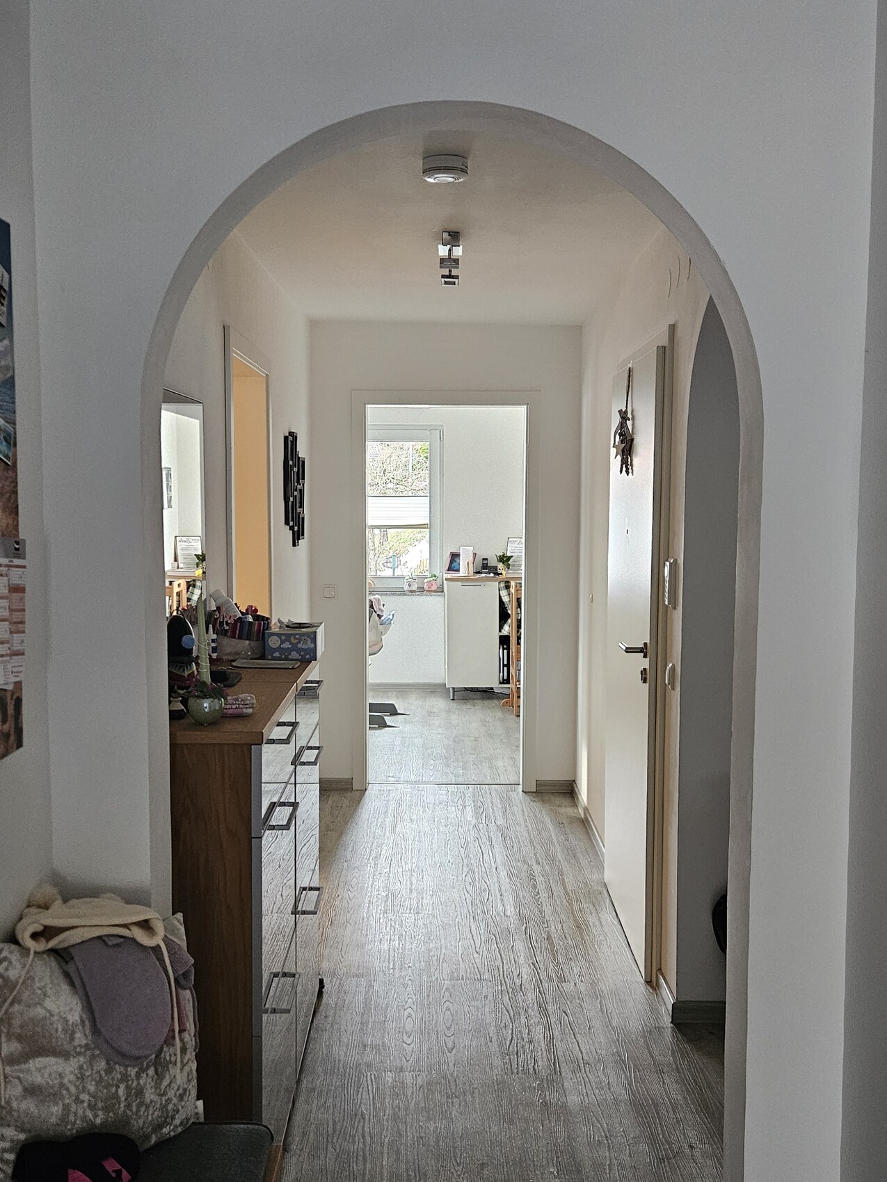

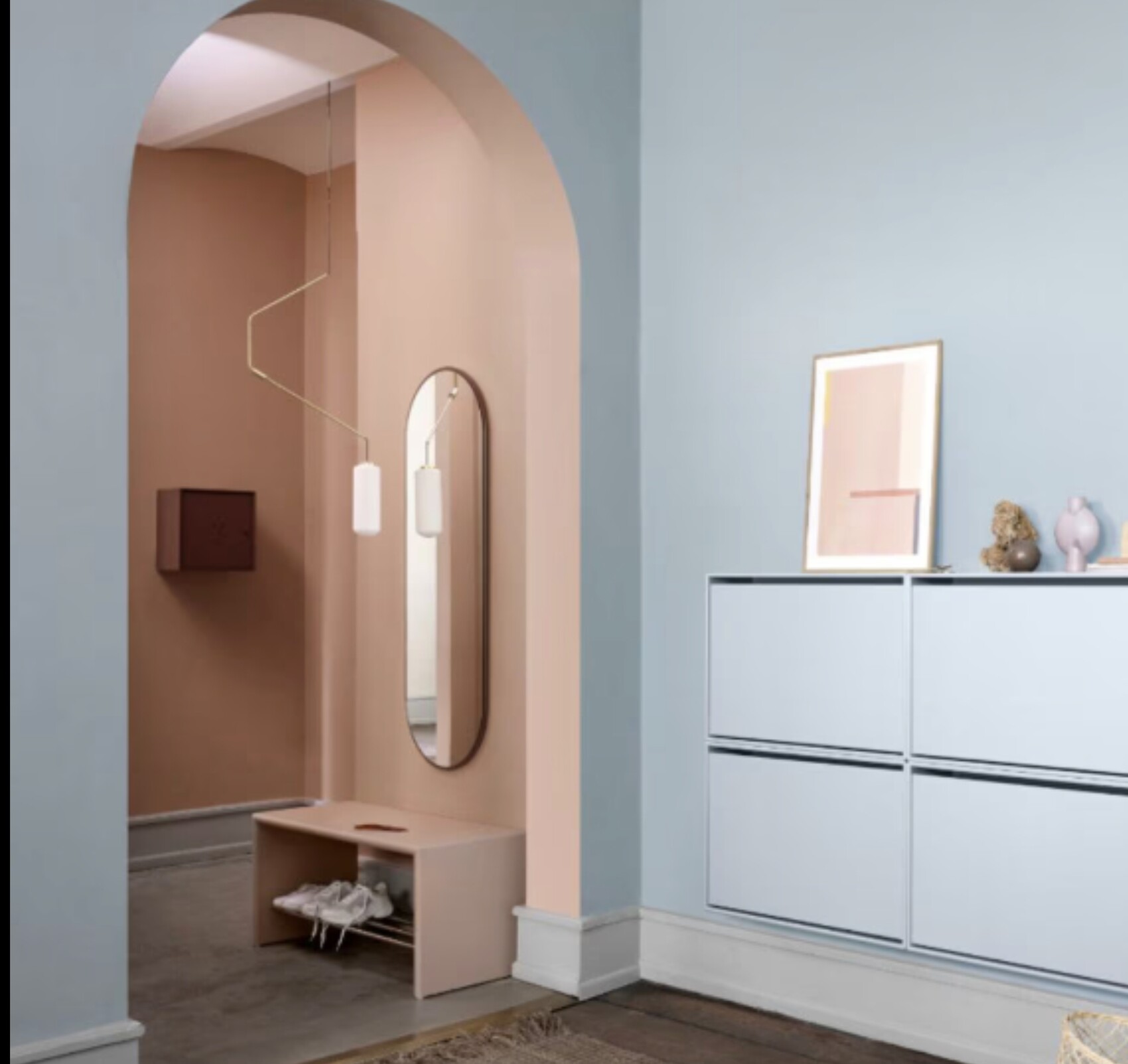

This is currently our plan or idea for the kitchen, and it will be implemented about 95% as shown. The galley kitchen layout was also an option for us. For cooking with several people, I find the island better. If you mostly cook solo, in my opinion a galley kitchen with sink/trash - work surface - cooktop is ideal.
I don’t want to convince anyone here, but I do wonder why there is such a strong negative reaction to arches. Attached are two pictures: one of our current arch, and one of a nicely designed hallway, similar to what I could imagine for us.
wiltshire3 Feb 2025 10:19roteweste schrieb:
I’m not trying to convince anyone here, but I do wonder why people are so quick to criticize the arches.People tend to frown when something is implemented that’s considered outdated. In the pictures, the arch serves as a design feature, framing the view into another part of the building from the chosen perspective. To me, the images look quite appealing. It’s purely a matter of personal taste.M
Maulwurfbau3 Feb 2025 10:21I agree completely. Purely a matter of personal taste. Not my preference, but a matter of taste nonetheless ;-)
I also believe that everyone can see it differently. My only question is what you want to achieve with it. Will it offer me advantages in terms of functionality or usefulness, or am I creating an aesthetic "advantage," such as a recognizable style? The risk I often see is that when you combine random elements, you run the risk of ending up with a mismatched style often referred to as "Gelsenkirchen Baroque." I think it’s important to consider this carefully. I have traveled to several Arab countries and therefore like rounded arches and ornamental details; however, this style would need to be consistent throughout the house (and probably extend to the exterior as well). Mentally, I can also relate it to our simple 1960s terraced house combined with brutal oak furniture and the orange circular wallpaper in my childhood bedroom hallway.
