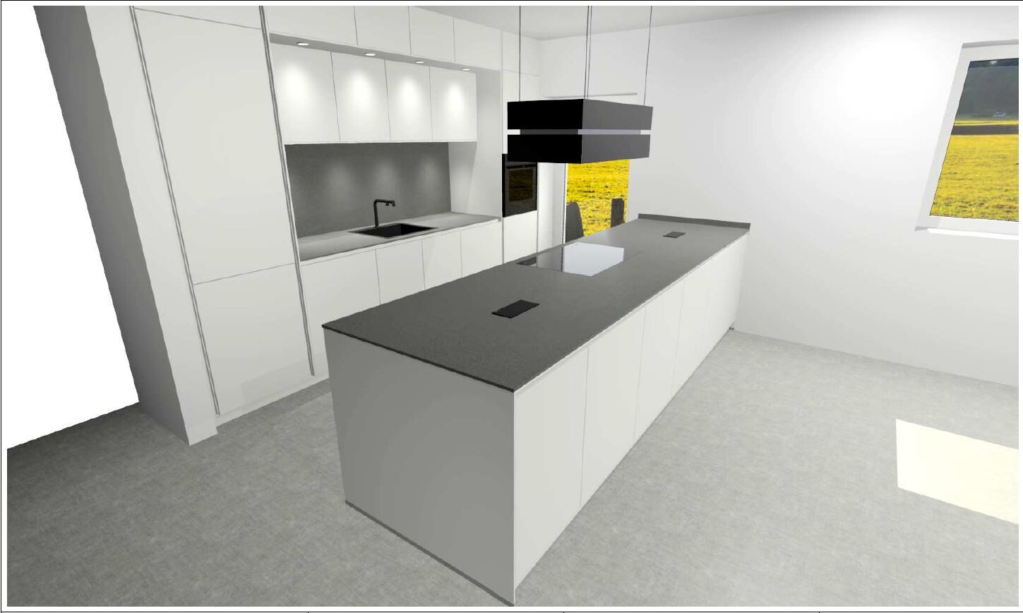

MachsSelbst2 Feb 2025 22:38Again, a reminder: for a kitchen of this size, it is advisable to include at least a second cavity for an oven or other built-in appliances.
Please don’t misunderstand me. I’m genuinely asking because it’s not entirely clear to me yet—not because I want to keep going over the topic: Are you placing the kitchen around the corner specifically so it’s not visible from the living room? Are there any other reasons? So would rotating the house and arranging it in a straight line (“I” shape) with corresponding walls also be an option?
There is no direct door to the living room to make it more relaxed? The compromise means you have to enter the living area through the kitchen, right?
@Katja: No. We have just started planning our kitchen and found that an L-shaped layout with an island is more cost-effective than a U-shaped one. The main advantage is the shared workspace for the large family and the direct access to the sink/trash from the dining room/south-facing terrace. You don’t have to walk all around the U each time.
Maulwurfbau3 Feb 2025 09:16As I mentioned before, we have a similar floor plan, especially in the kitchen area, and deliberately created an open-plan space. It never occurred to us to design the kitchen in a U-shape. We really dislike features like those rounded arches. They remind us of 1970s and 1980s elements from low-cost apartment blocks or older single-family homes with brown bathroom fixtures. But well, if someone likes that style, fair enough.
This is currently our plan or idea for the kitchen, and it will be implemented about 95% as shown.
