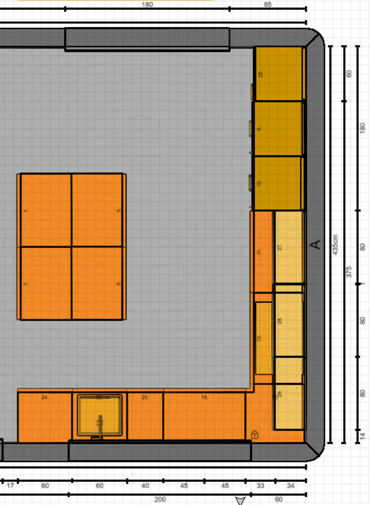

roteweste2 Feb 2025 20:30
kbt09 schrieb:
I find the sofa placement counterproductive because it encloses the room again.
We agree with that. The planner just drew it like this for now. What we are imagining is more of a chaise longue, but facing away from the room (more like mirrored).
Regarding the kitchen: This is the current plan. The exact dimensions of the island are not yet finalized.

kbt09
2 Feb 2025 21:49
Purple indicates slightly too much space, and green slightly too little. I would reduce the purple space by about 20–30 cm (8–12 inches), to a maximum of 110 cm (43 inches), and increase the green space by about 20–30 cm (8–12 inches), to a minimum of 90 cm (35 inches). In my opinion, the left edge of the island does not need to align exactly with the end of the lower L-shape section. Therefore, I would rather emphasize the lower section more and, for example, change the 90 cm (35 inches) base cabinet to a 100 cm (39 inches) one. Or, since it’s visible anyway, possibly add a 15 cm (6 inches) cabinet with a door to the left of the dishwasher for something like a towel holder. This would also save a panel or support to the left of the dishwasher.
Lagerplan mit Boden, orange Regalen an Wänden; Freiraum; blaue und grüne Pfeile kennzeichnen Abstände.
wiltshire
2 Feb 2025 21:51
kbt09 schrieb:
Purple indicates slightly too much space and green a bit too little. I would reduce the purple by about 20 - 30 cm (8 - 12 inches), max 110 cm (43 inches), and increase the green by about 20 - 30 cm (8 - 12 inches), minimum 90 cm (35 inches). In my opinion, the left edge of the island does not need to align exactly with the end of the lower L-leg.
I completely agree with the assessment of the distances and the idea of letting go of the imagined alignment—if it is to be the island.
Depending on how you cook, and since cooking is often a shared activity, especially when others are already sitting at the table, I would consider placing the cooktop on the island to allow cooking facing into the room.
kbt09
2 Feb 2025 22:15
I find a 160cm (63 inches) wide island too small. With an 80cm (31.5 inches) or 90cm (35.5 inches) cooktop, there isn’t much space left on either side, which affects the cabinet layout. Nowadays, cooktop extraction systems like Bora are popular in islands, which also reduces the storage space in the base cabinets.
A large island like that is great for baking cookies or pizza, hosting guest buffets, and so on, especially with three children and a family.
