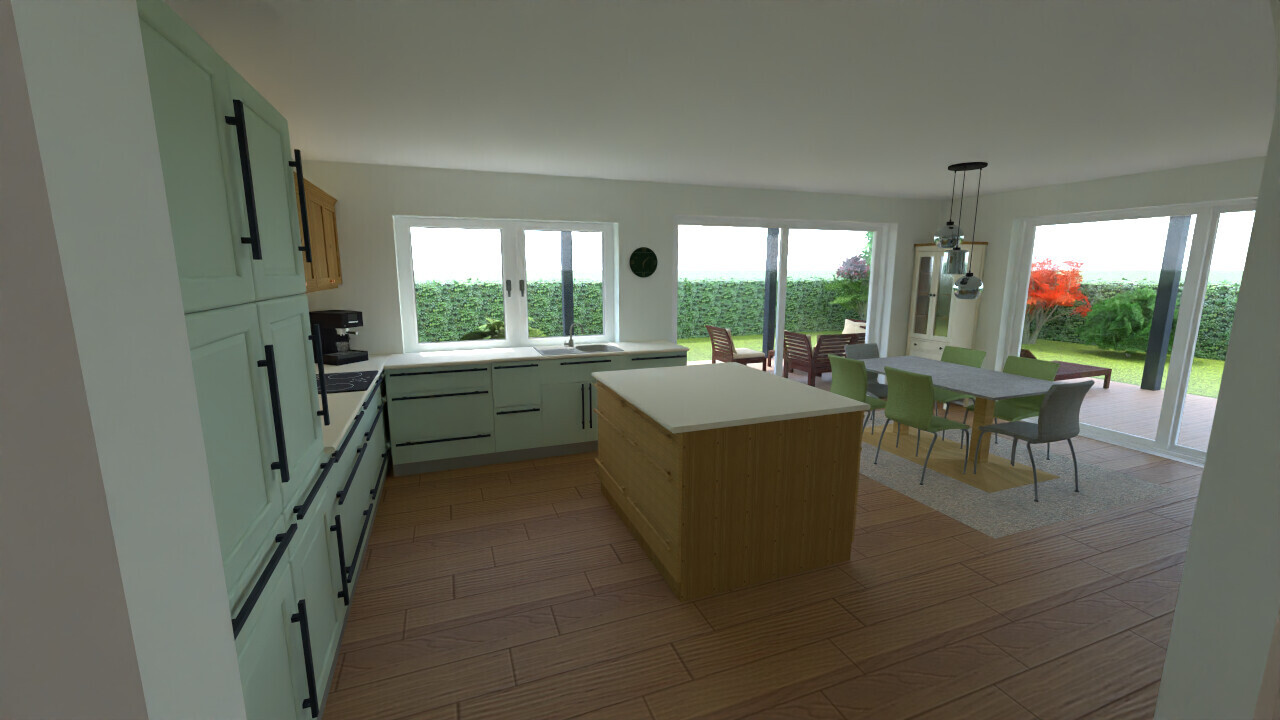

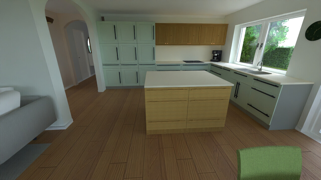

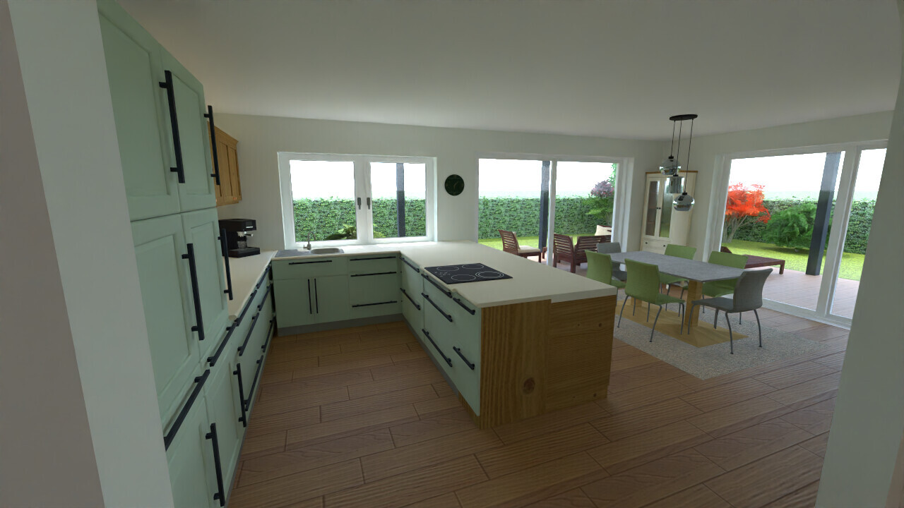

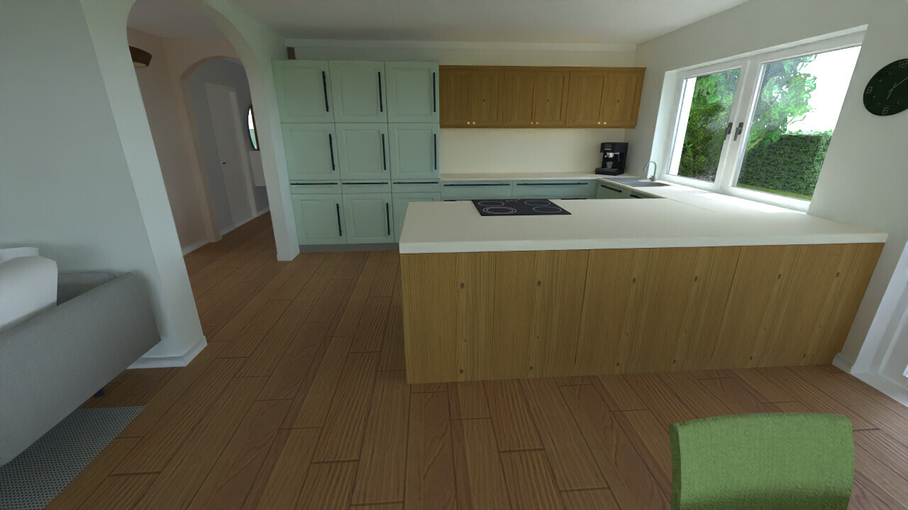

A quick update: We are currently preparing the building permit / planning permission application and are considering the kitchen layout. We have actually been leaning towards an L-shaped kitchen with a work island. This would also address the concern that passing through the kitchen to get to the open-plan living area is not ideal. Here are the renderings:
U-shaped kitchen:
Modern kitchen with green cabinets, cooking island, dining table, and garden view.
Modern kitchen with island, glass-ceramic cooktop, mint green tall cabinets, and window with garden view.
L-shaped kitchen with island:
Modern kitchen with light green cabinets, kitchen island, and dining area with garden view.
Bright kitchen with mint green cabinets, kitchen island, sink by the window, and wooden flooring.
K a t j a2 Feb 2025 12:05
Well, sorry. From my point of view, nothing gets better there. Everything that regularly sits around as clutter and unwashed dishes is what greets you first. But visually, I find the kitchen nice.
