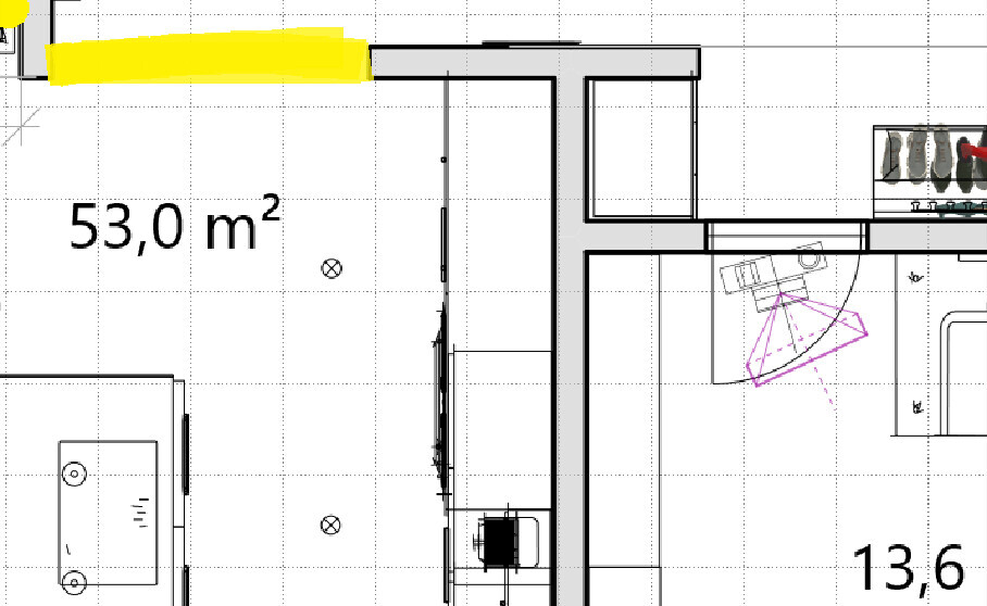

roteweste schrieb:
I came up with a solution that provides generous access to the utility room and at the same time allows space for an internal sliding door. If I don’t need new glasses, the sliding door is also invisible (?)

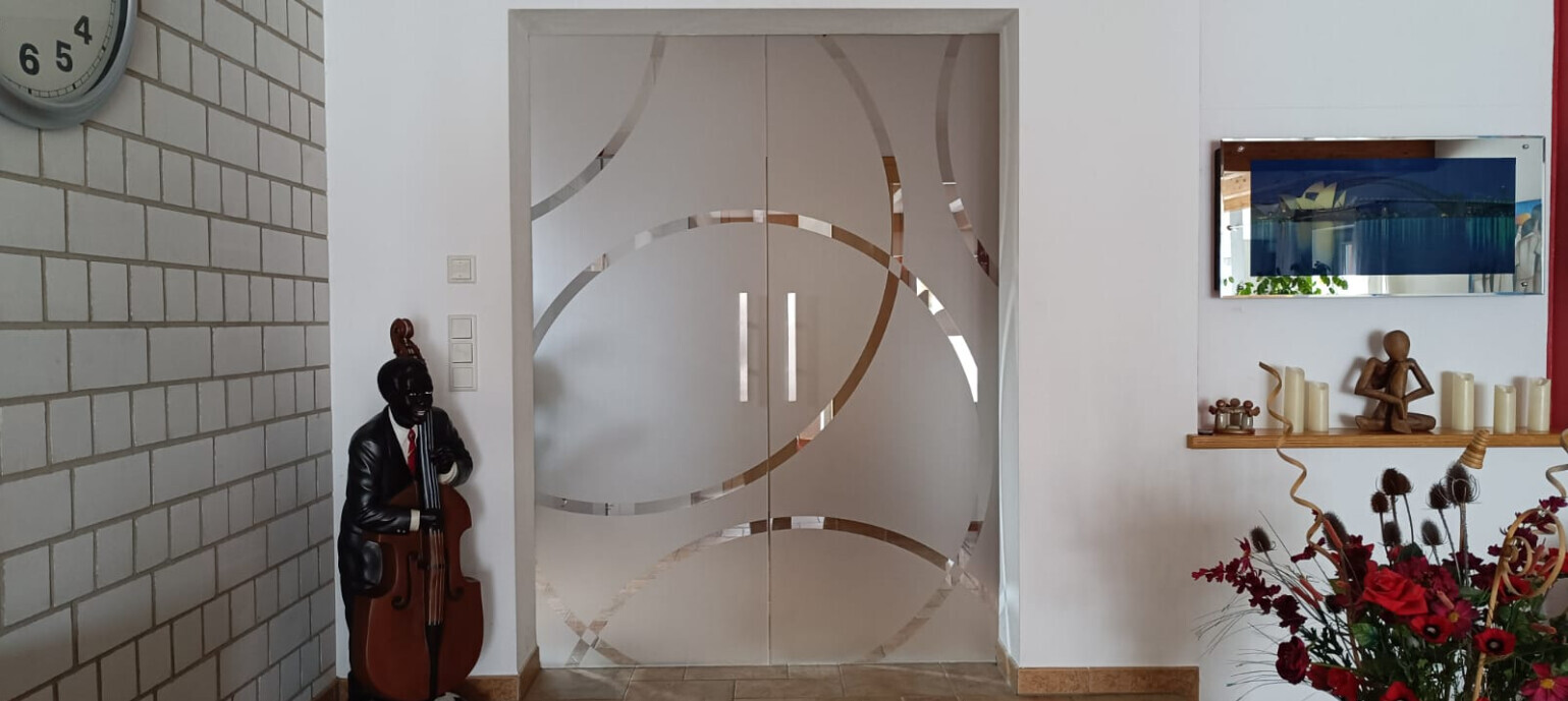

wiltshire7 Jan 2025 19:3111ant schrieb:
If I don’t need new glasses, the sliding door is practically invisible (?)The manufacturer of these doors is called invisible and, like many great interior design products, comes from Italy.We have a sliding door to our bathroom. It works really well.

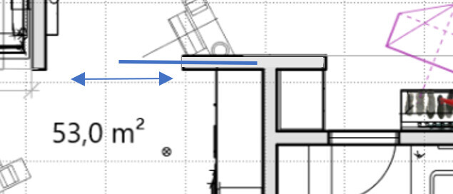

If I don’t need new glasses, the sliding door would also be invisible (?) The sliding door would then be installed inside the wall. It could then slide here:
That’s a tricky detail anyway: the window faces the driveway in front of the garage, and the door leads into the garage itself (which, as far as I remember, has a height difference of 0.3 m (12 inches), so two steps are needed for the passage, and it would have a flush beam at ceiling level). I’m still missing details on this, but the architect is only supposed to work up to and including design phase 3. We’ll see how we finally solve the utility room. The window and garage access would be very valuable to us. It’s easy to “fix” later. That way, we would definitely have enough wall space.
hanghaus20238 Jan 2025 12:50wiltshire schrieb:
The manufacturer of these doors is called invisible and, like many great residential designs, comes from Italy.
We have a sliding door for our bathroom. It works really well. After a long search, I gave up yesterday.
