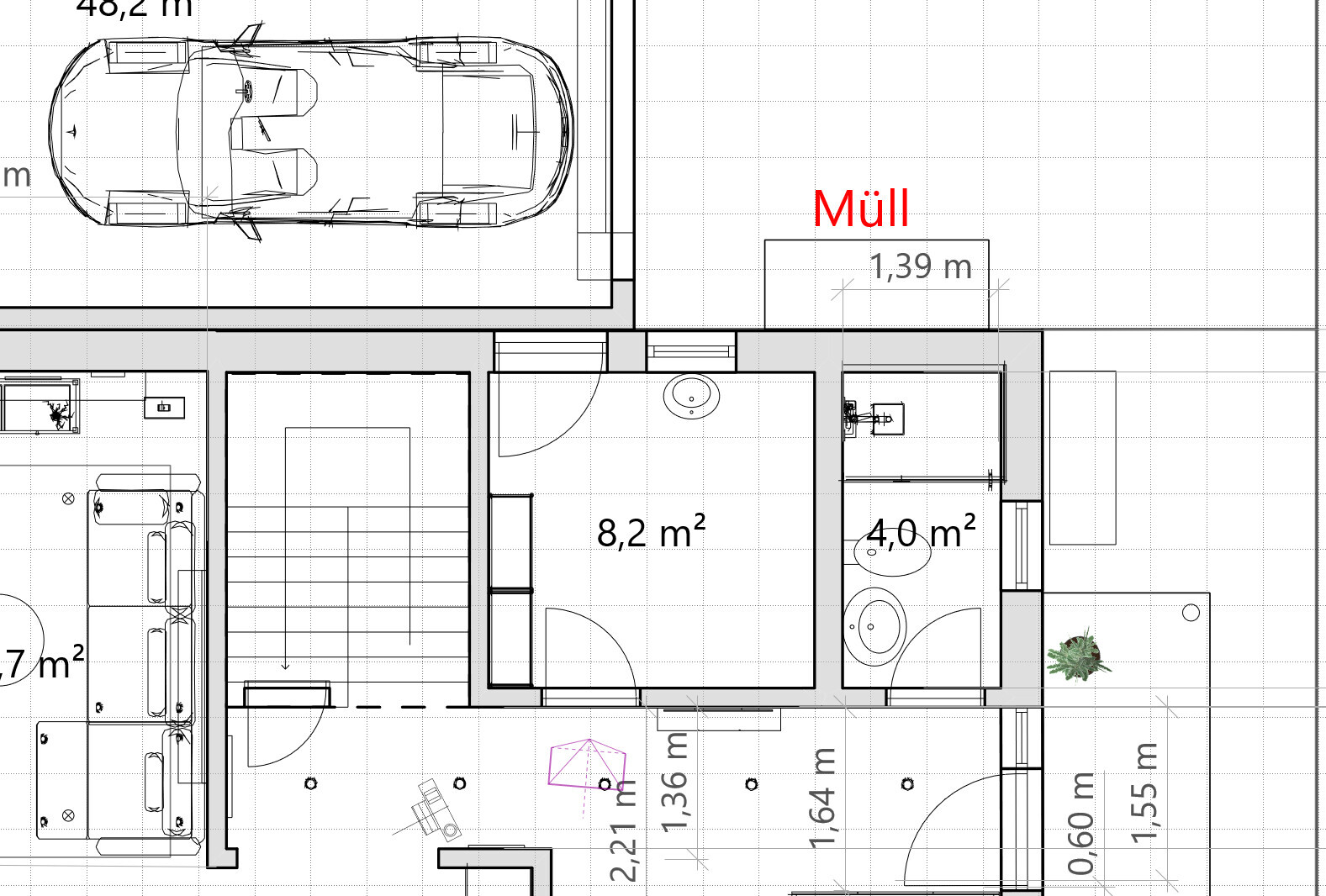

Hello 11ant,
nice to see you’ve written something again. We will definitely take the measurements you mentioned into account for the next phase of our planning. From design phase 4 onward, the architect from the house-building company will take over. Hopefully, they know what they’re doing.
We’ve heard the same from other experts (literally). Honestly, three of the quotes were rejected immediately in our case. I didn’t expect the range for our house to be somewhere between 3k and 4.5k per square meter. Our calculation probably still works up to about 3.5k per square meter.
We have now narrowed our comparison down to three providers and will soon begin preliminary selection with them. It’s been and still is quite stressful.
We have now agreed about 90% to leave the door out for the time being. I’m still working on the remaining 10%. We’re still undecided whether to build it with or without a lintel. Do you have any advice? In any case, later on—considering three teenagers in the house—we could install a door cleverly.
We also went back and forth about the trash bins. They are currently positioned in the garage more or less as placeholders. At the moment, I consider a triple bin container on the north side the most sensible solution. Here are the original dimensions for such containers:
Thanks again to hanghaus at this point.

I share your skepticism regarding the double-wing living room door
Bicycles (and even more so trash bins) are not placeholders; their practical space requirements should definitely be adequately planned
I agree with the suggestion by @hanghaus2023 for a garage that is stepped to match the site height relative to the house
