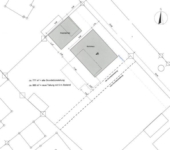

P.S. The site plan is not 100% accurate since we slightly enlarged the ground floor in the last round.

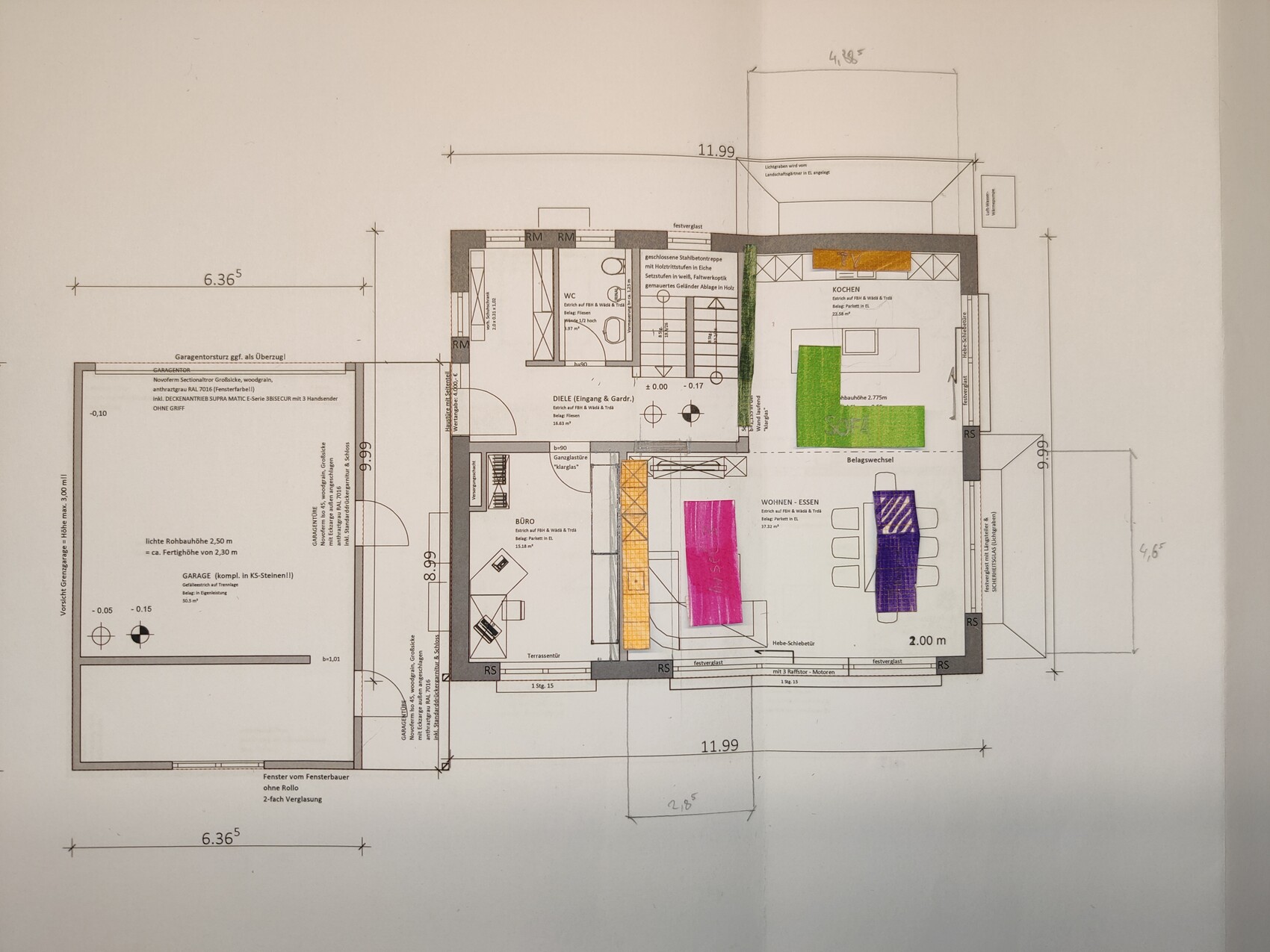

I see the living room corner as the main area of concern for you. Perhaps you could consider shifting the wall between the living room and the office by the width of the closet, so the living room gains more space. You could then place the sofa on the other side of the wall and position the TV next to the large window wall in the corner. This way, the short side of the sofa would face the TV, but still provide seating for 2-3 people.

I also really like the floor plan from ivenho, although it is fundamentally different with a straight staircase. I wasn’t able to come up with a good floor plan that includes a straight staircase with access to the basement.

HappyEnd schrieb:
I also really like the floor plan by ivenh0, but fundamentally different with a straight staircase. I couldn't come up with a good floor plan for a straight staircase with access to the basement. That’s not correct, we have the same staircase design. I can share a link shortly. You will immediately notice the similarity to your floor plan, but hopefully also the key differences.

Thank you for sharing the link. The similarity is noticeable, and we are slowly getting closer! :-)
We are gradually becoming more comfortable with swapping the living room and kitchen. The glass sliding door would move along with the kitchen. Possibly, a sliding door combined with a fixed glazed panel would also look good.
The kitchen island would need to be reduced by about 20cm (8 inches). In this proposal, the kitchen island would be parallel to the dining table. I personally would have preferred a right angle between the island and the dining table. The kitchen would no longer have direct access to the terrace. We could live with that drawback. The living room would definitely become cozier.
I would like to move the wall between the kitchen and the office. A depth of 40cm (16 inches) should be sufficient for a filing cabinet.
Do you see any further potential for optimization on the ground floor?
And I’m not a fan of always placing furniture in front of floor-to-ceiling windows or sliding doors. In that case, I might as well skip it altogether....
Swapping the kitchen and living room definitely makes sense. I wouldn’t want to miss having the kitchen next to the terrace anymore.
Why not simply keep the couch as in V1 and reconsider the sliding door? Nobody really goes through there anyway... 😉
Our situation is special in that we will have a relatively large plot of land for at least the next 10 years. The plan is to sell part of it after 10 to 15 years. Therefore, it is important for us to have access to both sides of the garden. The terrace is planned to be built facing southwest / at the bottom of the plan. Attached is the site plan again...
