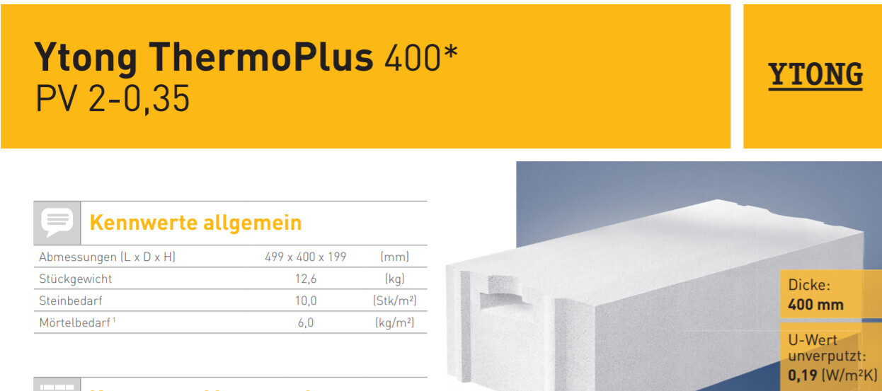

My surprise about the wall thickness simply came from not knowing any manufacturer that offers this stone thickness in their range. There might be one, otherwise the planner probably wouldn’t have considered this format, but it would certainly limit the choice of manufacturers (?)
By planing down the bay window line, the upper floor becomes a bit larger, which the bathroom and one of the children’s rooms probably won’t use to that extent without further modifications. Thanks for that as well, since it perfectly illustrates my advice to derive the ground floor from the upper floor rather than the other way around.
Tolentino schrieb:
Maybe thermal blocks?After sand-lime bricks in 20cm (8 inches), it was probably only a matter of time before an intermediate size was introduced. Let’s see if and when it becomes widely accepted; then I could be okay with it—though I don’t like it if it limits the choice of manufacturers. If I have a “neutral” wall thickness specified in the building plans, it’s easier to switch than if certain thicknesses are only available from a few manufacturers for one type of block and possibly none for another. But well—at least I’m glad that instead of jumping straight to fortress-like walls above 36.5cm (14.5 inches), it’s just about a 10% increase.https://www.instagram.com/11antgmxde/
Tolentino schrieb:
Is there also a 500mm (20 inch) version?More is more *LOL*https://www.instagram.com/11antgmxde/
