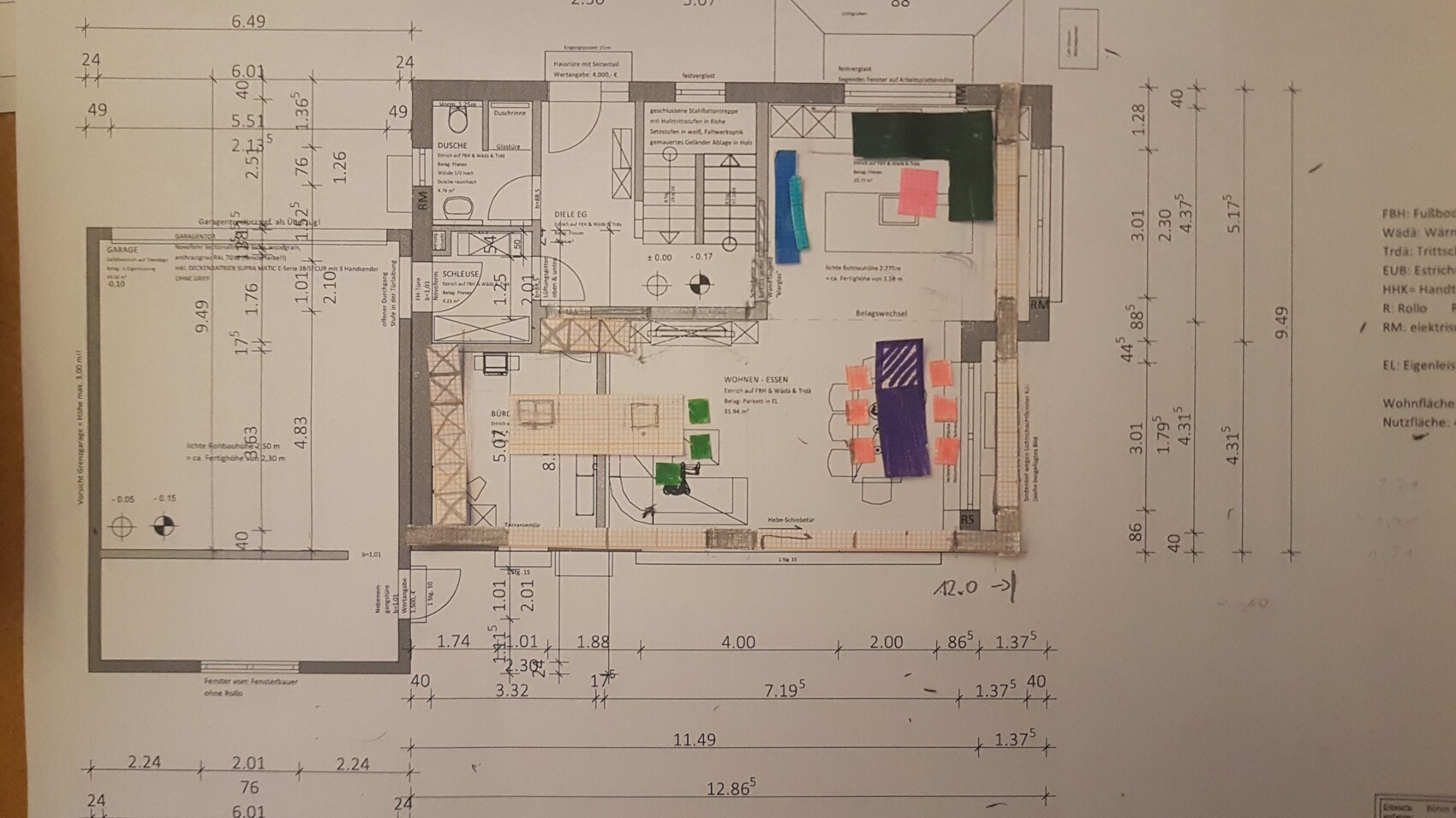

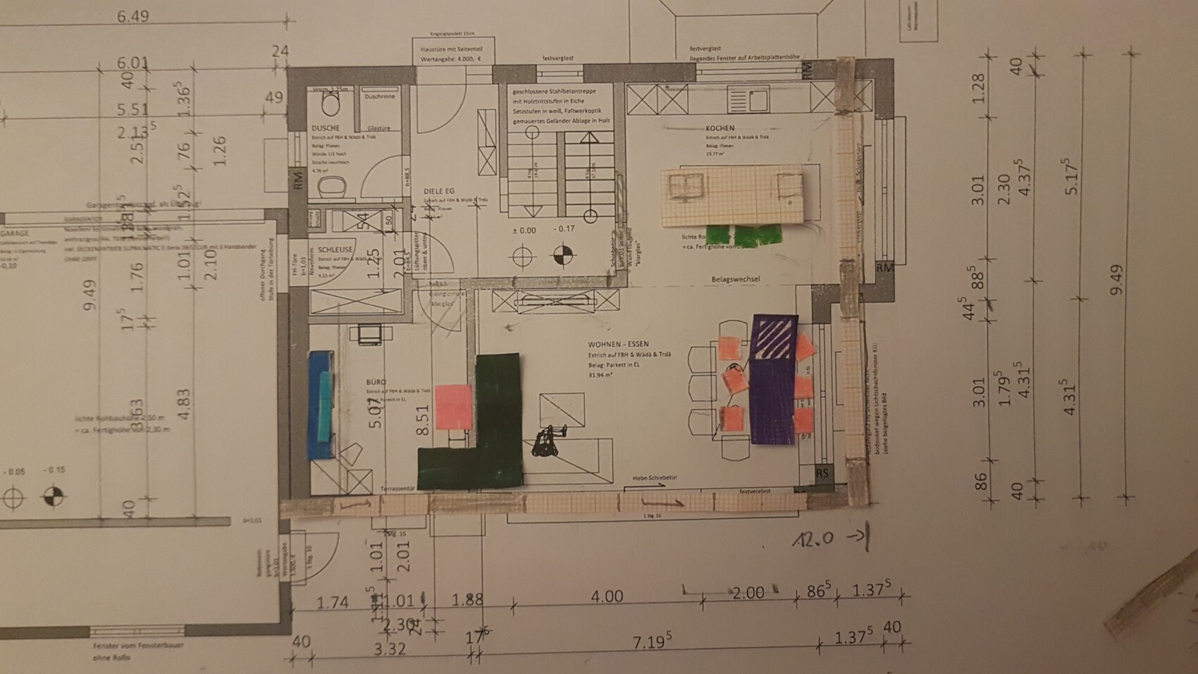

I have given it some more thought and come up with two options. Since revising through the GC seems too complicated, I took some time this evening to do a little DIY session.
Both Option A and B include a sofa, TV, TV stand, and an extendable dining table drawn to real size. Both options now have a house width of 12 meters (39 feet), and the kitchen bay has been removed. I moved the office/home office to the basement. I am still thinking about how to create a separation between the hallway (underneath the platform staircase) and the living/dining area.
I imagine a single glass sliding door almost 2 meters (6 feet 6 inches) wide might be too heavy. One possibility would be two panels of 90 cm (35 inches) each running on two track systems and then sliding into pockets in the wall on the left side. Or maybe two swing doors, but then one door might be intrusive in the room when open. Perhaps someone has another idea… My gut feeling is that this door would mostly remain open, but not always. Still, I don’t want to miss having it.
In Option A, I swapped the living room and kitchen and thought about having low windows in the living room so we are not fully exposed to views from the top side or the street. In Option B, I kept the living room in its original place and enlarged it by including the space from the previous office.
I’m curious to hear your opinions, although I already suspect which option will be more popular. I would appreciate further suggestions for improvement, especially regarding the windows, as I’m struggling with that.

Option a seems more appealing at first glance because this corner is better utilized by the cloakroom vestibule, and the space is more efficiently covered overall. In option b, you have unused expensive space in the middle (although I would rotate the dining table in each case).
Question: How large do you want the kitchen to be? In option a, it is already quite large and will certainly not be cheap.
Both options are definitely an improvement. Contrary to the large group of people who would always plan the kitchen facing the terrace, I consider everyday habits to be the decisive factor.
For example, my living room and sofa would always be oriented more towards the garden/view and only secondarily towards the TV, as I prefer a nice view (while reading, playing, or with guests) and would certainly spend more time there than in the kitchen. We also really enjoy sitting at the dining table for long periods. The 3 meters (10 feet) extra distance from the kitchen to the terrace would not bother me.
Therefore, option b would be more my choice. (A fireplace as a room divider between living and dining areas would work perfectly here, but you don’t want that, of course.)
