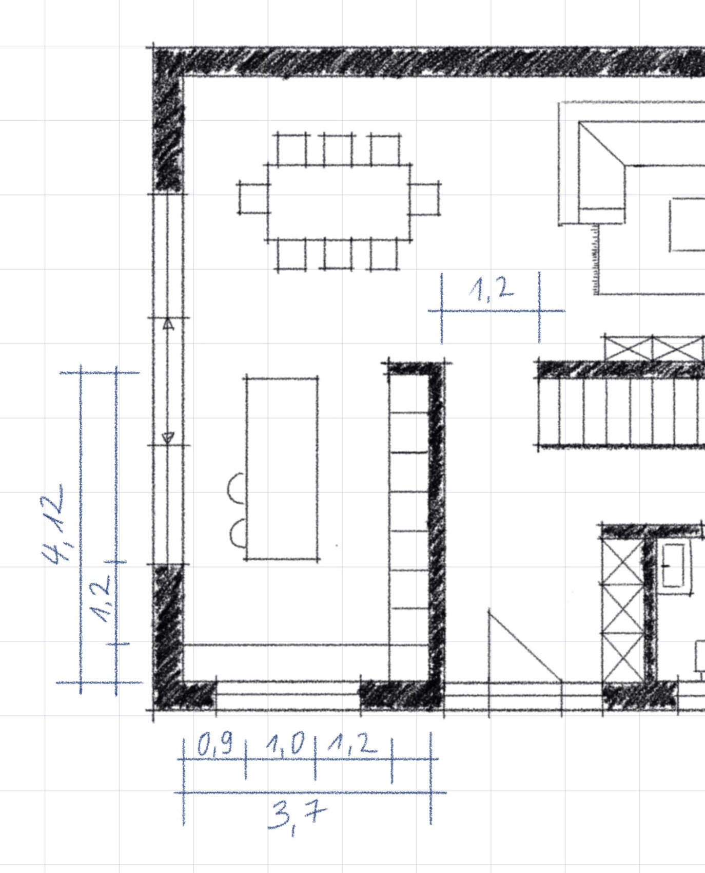

Hello everyone.
After following the discussions for a long time, I would now like to ask for your feedback.
As you can see from the questionnaire, the current design was created solely by me.
I can provide detailed dimensions later if the grid drawing is insufficient for clarity.
Preliminary notes:
- 1 square equals 1 x 1 meter (3.3 x 3.3 feet)
- The northern wall is on the boundary line and must be built as a fire protection wall.
- The walk-in closet does not require a window.
- The small master bathroom could either have a fire protection window, as shown, opaque due to neighbor regulations above the toilet, or a strip window installed at a height of 1.8 m (5 feet 11 inches) across the entire width of the room.
- Lightwell in the office is planned larger, but the window is not floor-to-ceiling.
- Upper floor windows are not floor-to-ceiling.
- An additional door after the cloakroom could serve as a "windbreak," but this could certainly be added later.
I look forward to your feedback.

Alessandro schrieb:
I also made a sketch in PowerPoint because the drainage in your floor plan bothers me. In my opinion, it needs to be located somewhere on the south side to make sense. Is the drainage such a big (technical, acoustic, cost-related?) issue?
I looked at the plans of a friend’s completed house. The downpipes run inside the wall of the large living-dining area, and then they cross beneath the house towards the sewer...
evelinoz schrieb:
I don’t know how you’re calculating, but for me it looks a bit tight.
I’m short by 10cm (4 inches). A "aircraft carrier" (long island) looks okay at 90cm (35 inches), well. I did say that the 90cm (35 inches) is measured up to the window (not the wall).
I planned the island at 1m (40 inches). Still too narrow, the aircraft carrier?
