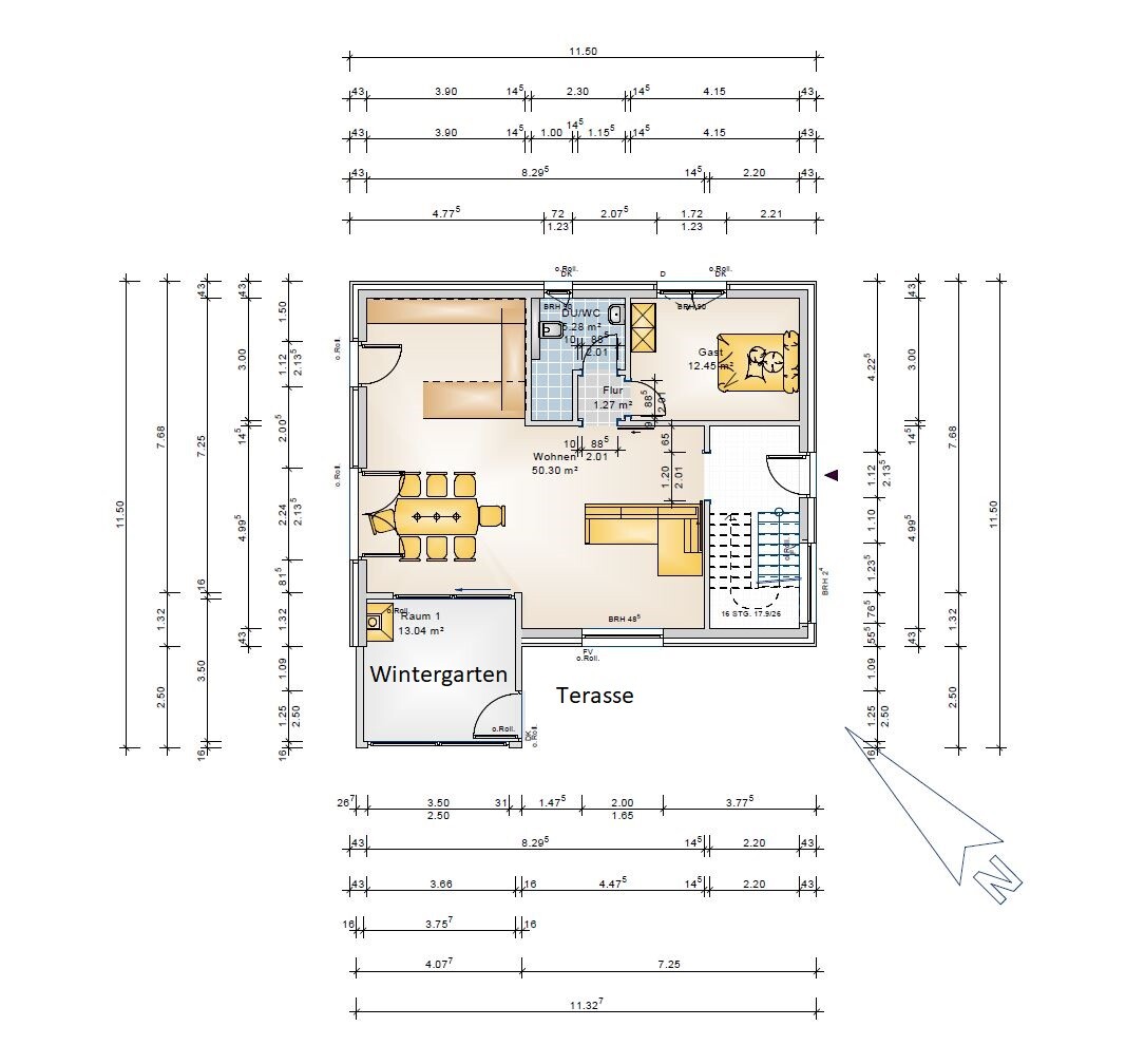

That’s exactly what it doesn’t: what is the room down there on the left side of the plan? The room with the stove... what is it supposed to be? A conservatory?
Don’t you watch TV? Shouldn’t you be able to go outside through the patio doors?

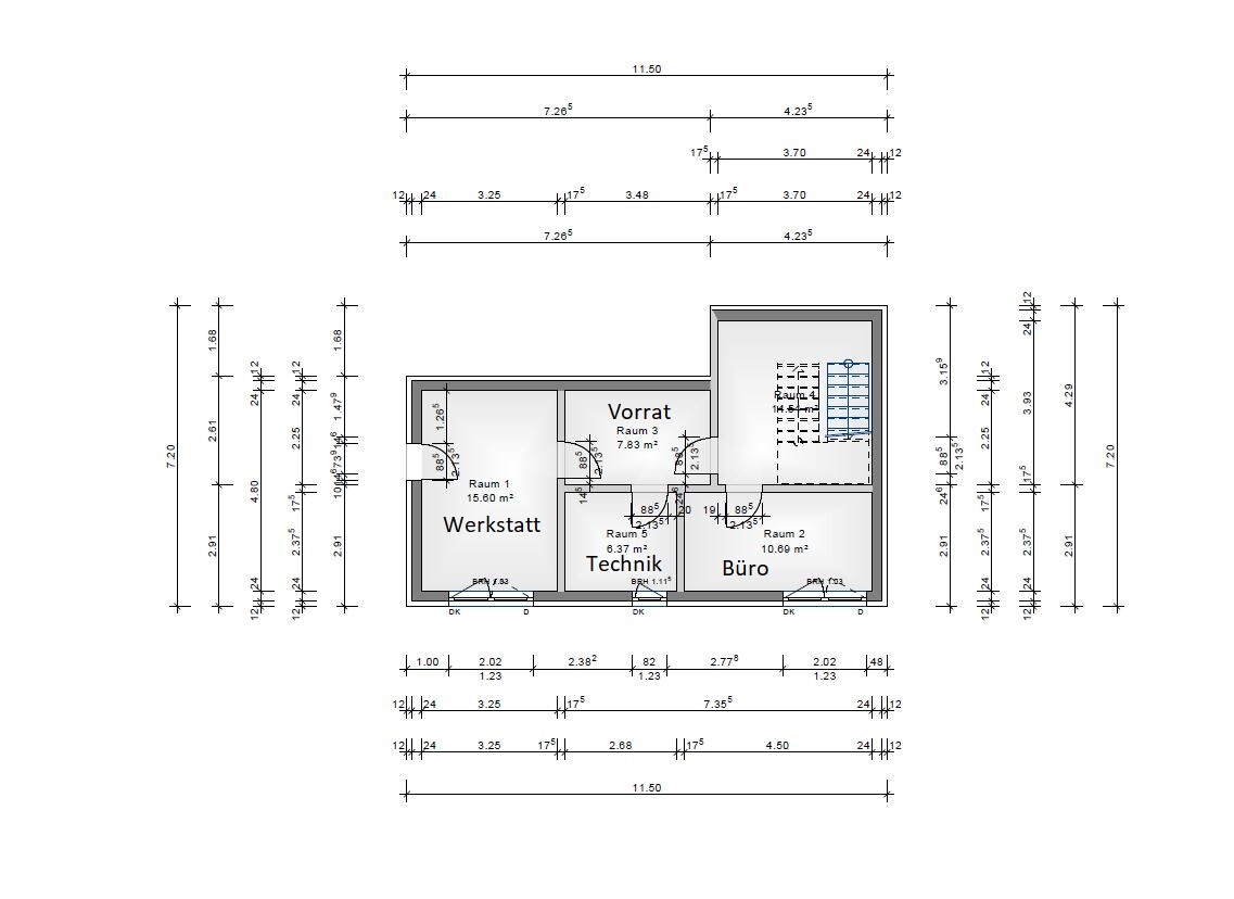

What is the basement for if the utility room is on the upper floor? Is this what you mean by “using the plot as it is”?

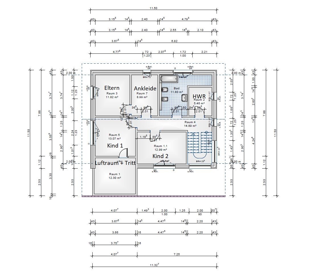

I don’t see that. You might want to put more effort into the upper floor. What are the trapped rooms supposed to represent? I thought you were planning for two children? No separate rooms for the kids?
On the ground floor, I don’t see the living area as a retreat: not only is it a passage area, but you also have to walk behind the sofa. That is anything but a quiet retreat.

Floor plan of a house: terrace, conservatory, living room, kitchen, bedroom.
Floor plan of a building complex with workshop, technical room, office, and storage
Floor plan of a residential building: master bedroom, dressing room, utility room, bathroom, two children’s bedrooms, hallway, and stairs.

Bedroom and bathroom are not accessible or barrier-free, even if the hallway is removed.
Terrace instead of garden access. With children, this is very impractical; without children, unsatisfactory.
Kitchen facing the outdoor dining area.
Living area’s quiet zone is located in a passageway.
What is the purpose of the conservatory/sunroom?
Do you have a TV?
Are the children’s rooms walk-through rooms?
What about the conservatory/sunroom on the upper floor?
Shower is too narrow.

I would remove the constraint of a two-family house, better integrate the basement (lower ground floor) into the design, and re-plan the upper floors.

Even then, the room is too narrow. Just take a look at the placeholder furniture—you won’t fit much more in there. I don’t see a double bed with age-appropriate clearance on both sides.

Children’s room open to the void?
