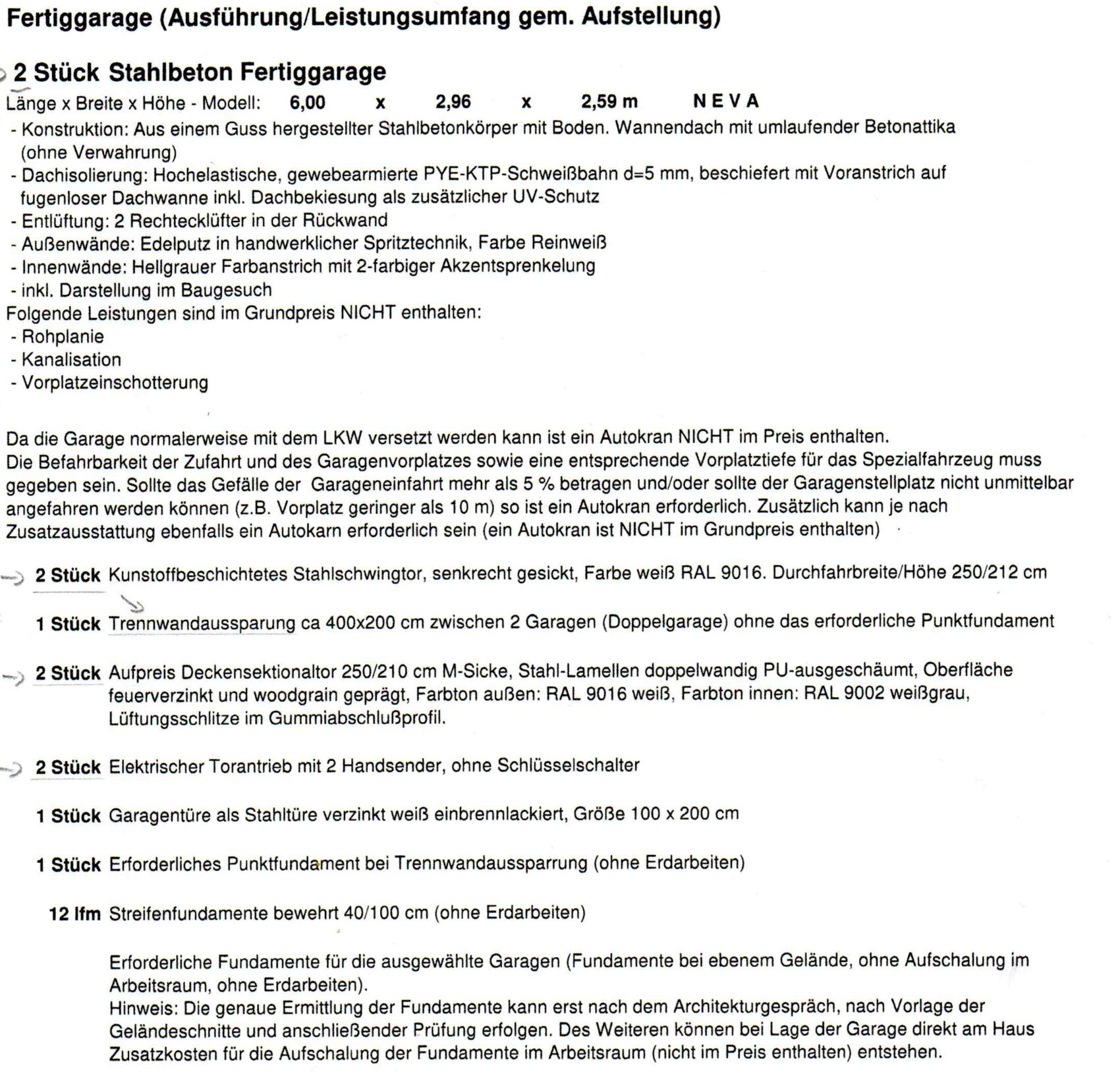

We are now considering removing the garage completely and commissioning a garage ourselves. How much money should one currently plan for a comparable double garage, for example from Ott or Zapf? We have a Neva double garage from Ott (see below) included in the house construction contract:
Does anyone have experience with this? Or any cost estimates regarding cellar construction?

The prefabricated house provider suggested basically placing another double garage underneath the garage, which they call a multipurpose room. Such detailed questions are nearly impossible to answer without knowledge of the house and especially the plot. If I understand correctly, the manufacturer wants to build the foundation quasi with masonry side walls and a floor, which to me sounds like a questionable solution. For a prefabricated double garage, I would have planned another prefabricated double garage underneath right from the start. Cases like this are when the “let’s-see-how-it-goes” planning approach proves to be quite costly.
I can well imagine that the prefab garage supplier will quote a new price under these changed circumstances that you probably won’t want to believe (or, if you don’t tell them about it, might not even unload the units).
Why join a forum like this if you only ask isolated questions, even though you have a sloped plot?
You could probably have saved a high five-digit amount just by discussing your whole project here from the start!
