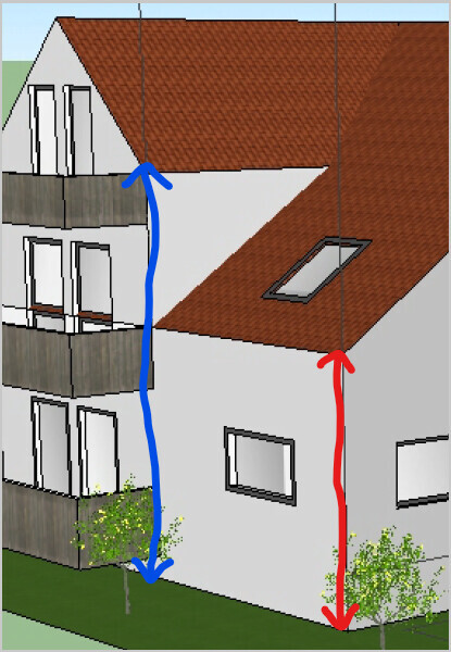

The development plan specifies a wall height of 6 m (20 feet) and a ridge height of 9 m (30 feet).
It is permitted to build a dormer.
Our question is: does the wall height refer to the distance from the top edge of the street to the intersection with the exterior wall, or from the top edge of the street to the highest point of the dormer?
Is the blue measurement or the red measurement relevant?
Perhaps someone knows a regulation or legal paragraph on this?
Thank you very much

superzapp10 Mar 2020 20:07Hi, in our development plan, the basics of how heights are calculated are explained (eaves height and ridge height) to avoid any misunderstandings. Is there nothing about this in your documents? Otherwise, just give the building authority a quick call or visit. That usually clears things up 😉
Familie HV schrieb:
Does blue count or red? Blue, unless the development plan explicitly allows exceptions.
Familie HV schrieb:
Maybe you know a legal paragraph about it? There isn’t one. It’s not necessary. It’s common practice, confirmed by case law.
