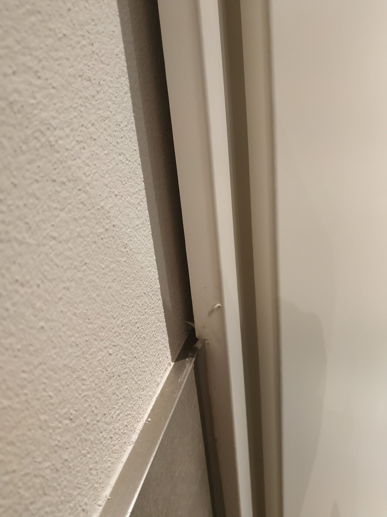

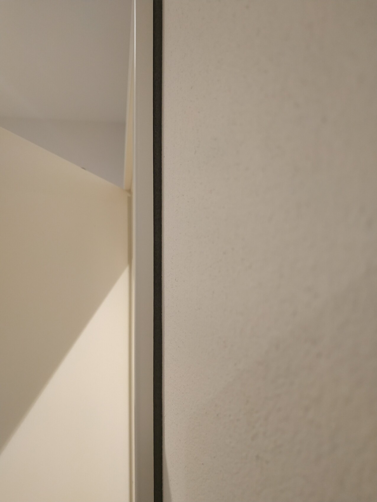

The interior doors have been installed in our new house. The measurements were taken before the tiler came. The walls were then tiled up to halfway, which meant that the door frame no longer fit because it was too narrow. The installer planed part of the door jamb but couldn’t go further due to stability concerns.
Now we have a large gap between the door frame and the wall. This is a disaster in terms of soundproofing, and any door installed would have the same problem. The company refuses to replace it, saying the fault lies with us. Regardless of who is to blame, I will take care of it myself.
How can I improve the sound insulation? Should I install a joint seal profile and seal it with silicone (see pictures)? Additionally, should I foam the entire area with expanding foam or something similar?

Reini12346 Mar 2020 14:03To provide some feedback here as well:
I have now insulated 4 door frames and conducted a very amateur test (using a CD player and a decibel app). Adding silicone seals probably won’t make much difference anymore.
- Two rooms are about 3 dB quieter
- One room is the same
- One room is about 5 dB louder
I once read that a 5 dB reduction feels like a 10 dB difference. Let’s see if it makes any noticeable impact in everyday life.
