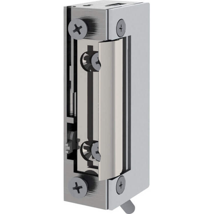

Mycraft23 Jan 2021 13:23
What you are looking for is called a door latch, and every locksmith carries this type of item. Alternatively, nowadays you can find these almost everywhere.
Close-up of a metallic door lock with screws and bolts.
Andre77
23 Jan 2021 13:27
Yes, exactly something like that. But there must be differences in height and width or depth, right, or is there only one version?
I would have to unscrew the continuous strike plate, and then it should be possible to replace it.
