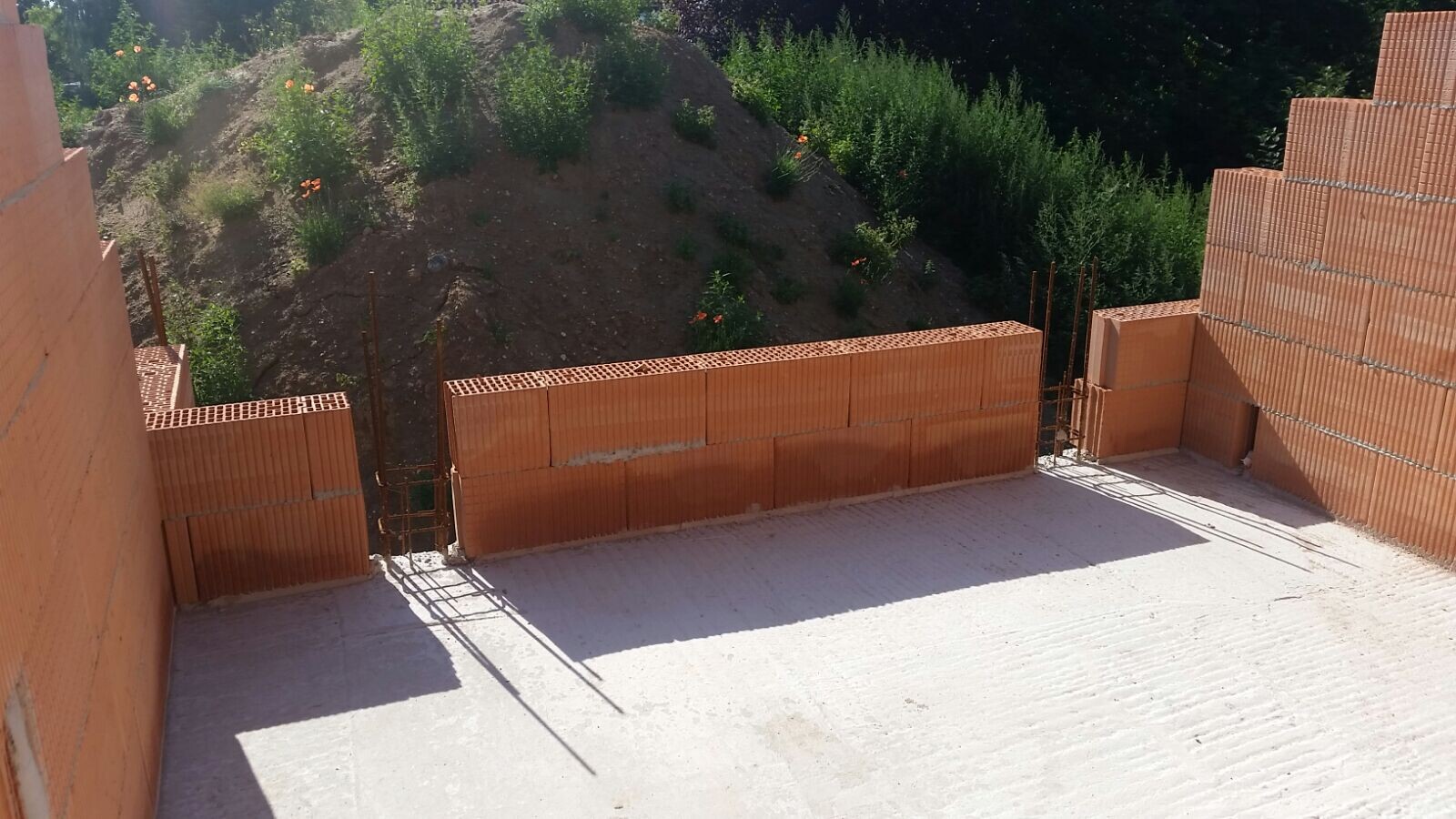

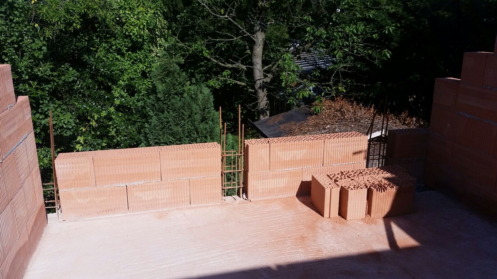

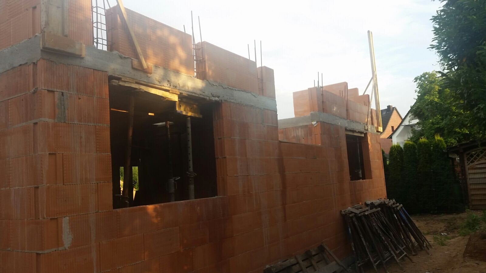

Bauherren201521 Jul 2015 12:26Good morning,
Thank you, Building Expert, for your response. We are building a solid masonry house, but we still often refer to the "Rähm." I also did some Googling, and the term "ring beam" came up... As you can see, we actually don’t know much about this.
I’m attaching a few pictures, so maybe you can answer my question better.

Sebastian7921 Jul 2015 12:48These are the bearing supports for the collar beams, including the concrete knee wall supports, which are already prepared. This is part of the structural carpenter’s scope of work.
We also installed a ring beam above all interior walls on the first floor to prevent cracks later on.
