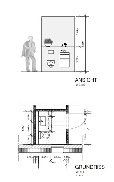

Attached is a drawing of our guest bathroom. The wall-mounted installation has unfortunately become almost 21 cm (8 inches) deep due to a ventilation pipe behind it. Because of this, we are now unsure whether the door should open inward or outward.
We will only install a hand washbasin with a depth of 36 cm (14 inches). With this, the door would just be able to open inward without hitting it.

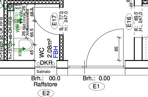

If the door opens outward, it just fits past the front door...
So, which is the lesser problem, or what would be more practical?
Aesthetically, I would actually prefer the door to open inward...
Thank you in advance for all your opinions and tips....

truce schrieb:
If you want a uniform appearance, you would have to have the door open inward, or install a suitable door that opens outward but has the door flush on the “inside.” For this reason, choosing a flush door exclusively for a guest toilet in this sense sounds to me like “nobility leads the world to ruin.”
