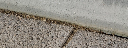

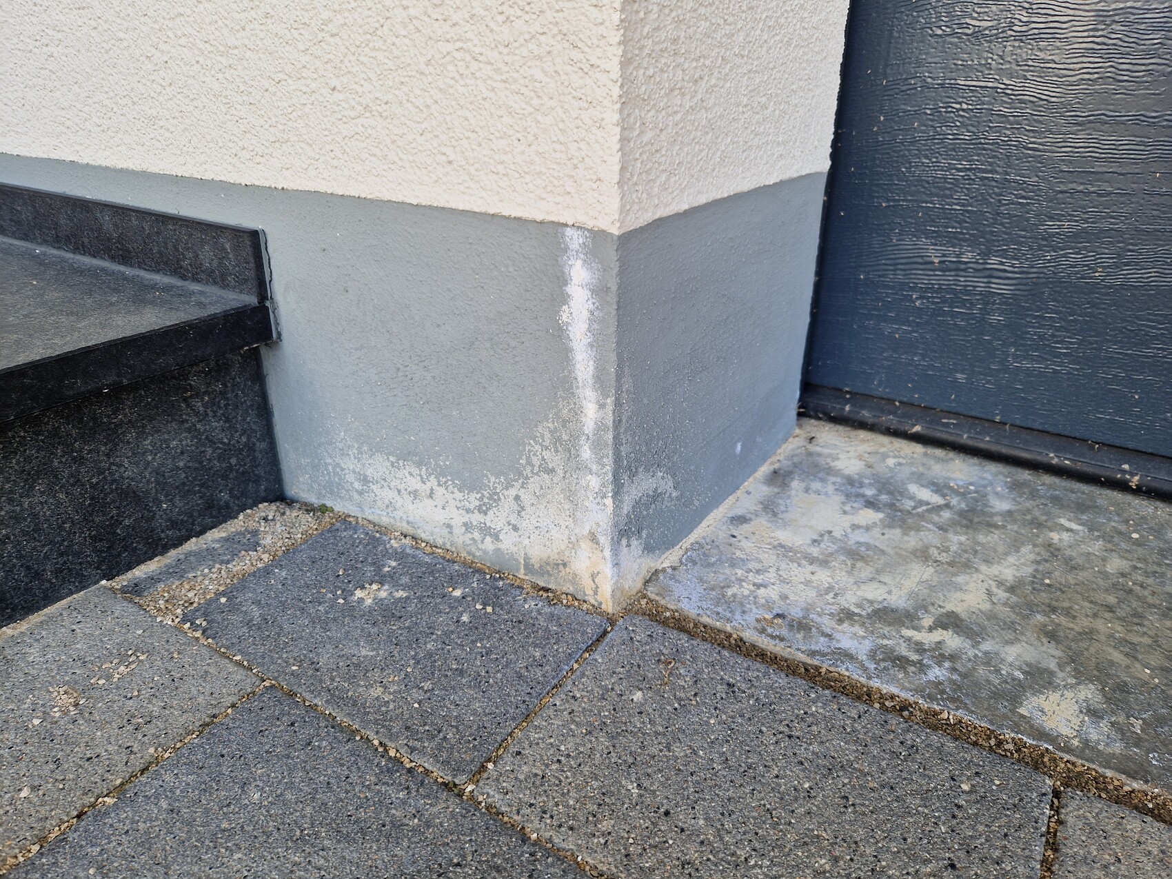

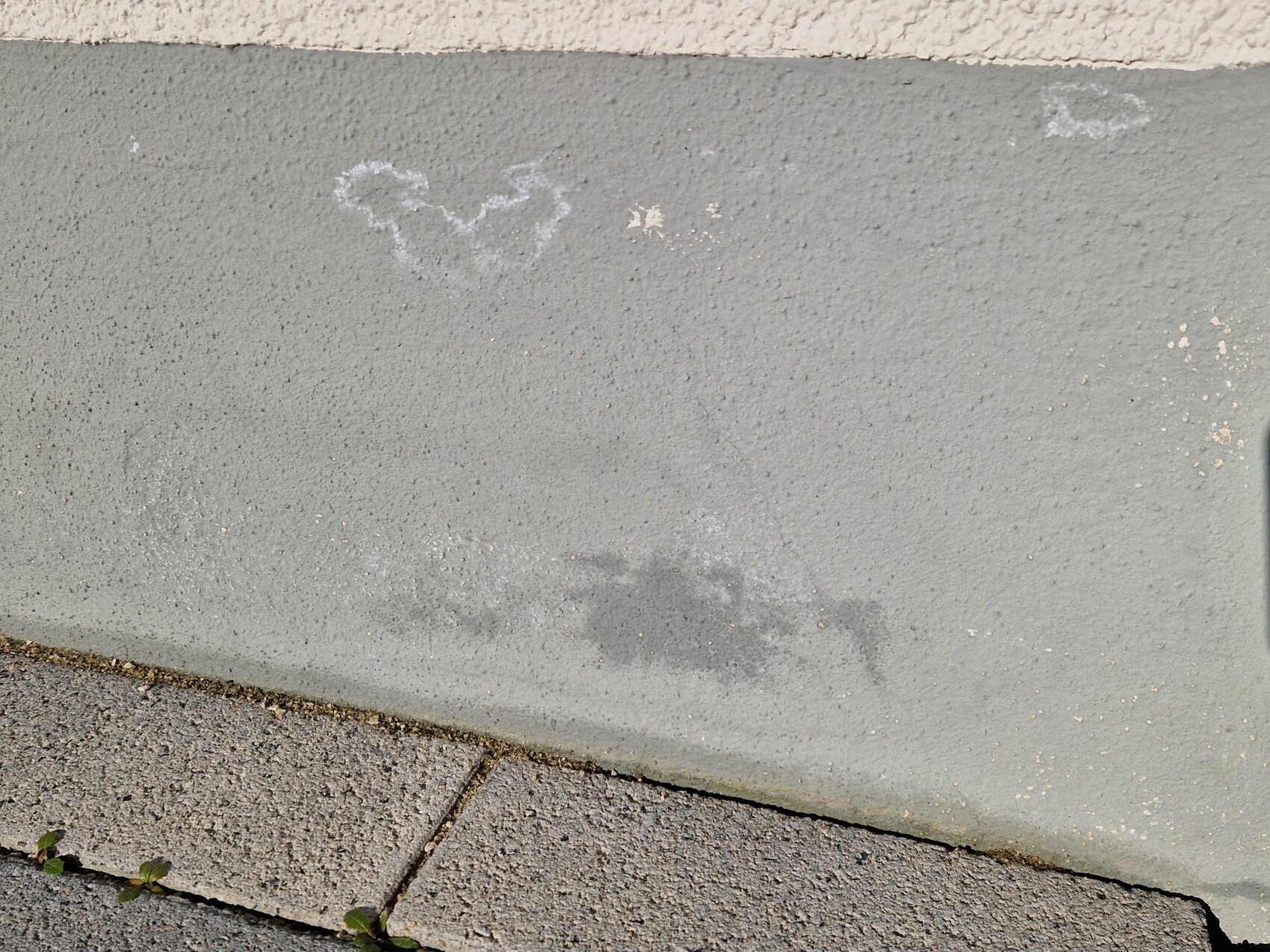

Does anyone know what this is?Rising damp caused by paving laid directly against the base of the wall, with sand grains visible right on the plaster surface.T
Teimo198812 Jan 2025 14:51I agree. From the pictures, it also looks like the dimple membrane is missing.
