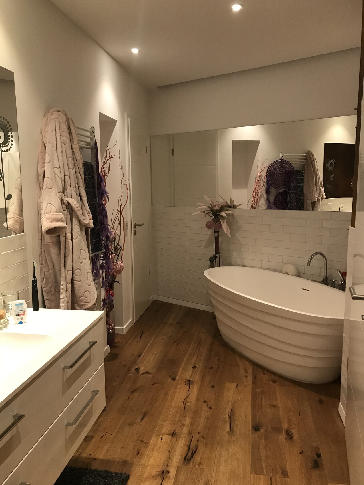

About six years ago, we installed rustic oak flooring on the upper floor and simply treated it with oil. The knots were originally filled with epoxy resin, which has the great advantage that larger damages can be repaired again with epoxy. We only had to do this once with minimal effort, and the floor still looks like new. Personally, I would not install parquet flooring in heavily used areas, as it is too sensitive for my taste. Especially lacquered surfaces can look worn out quite quickly.
