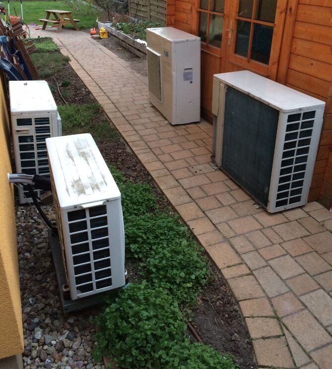

Sometimes it looked like this behind the house:
And yes, same here, I have never regretted the installation. But I would have appreciated it if someone had told me during construction: "Run a few lines for air conditioning in the walls."

Sometimes the setup behind the house looked like this:
Wow, I assume you got those cheaply or maybe for free? Or did you actually purchase four units? Were the refrigerant lines compatible with each other? Did you install the air conditioning system yourself?Similar topics
