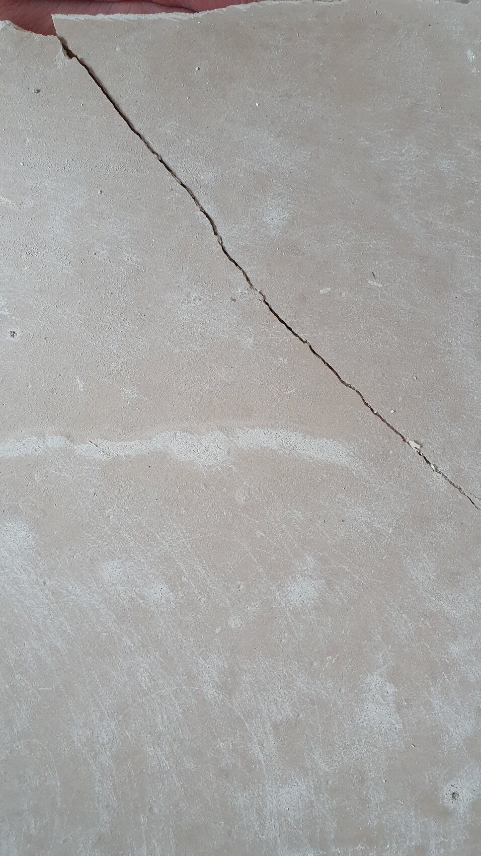

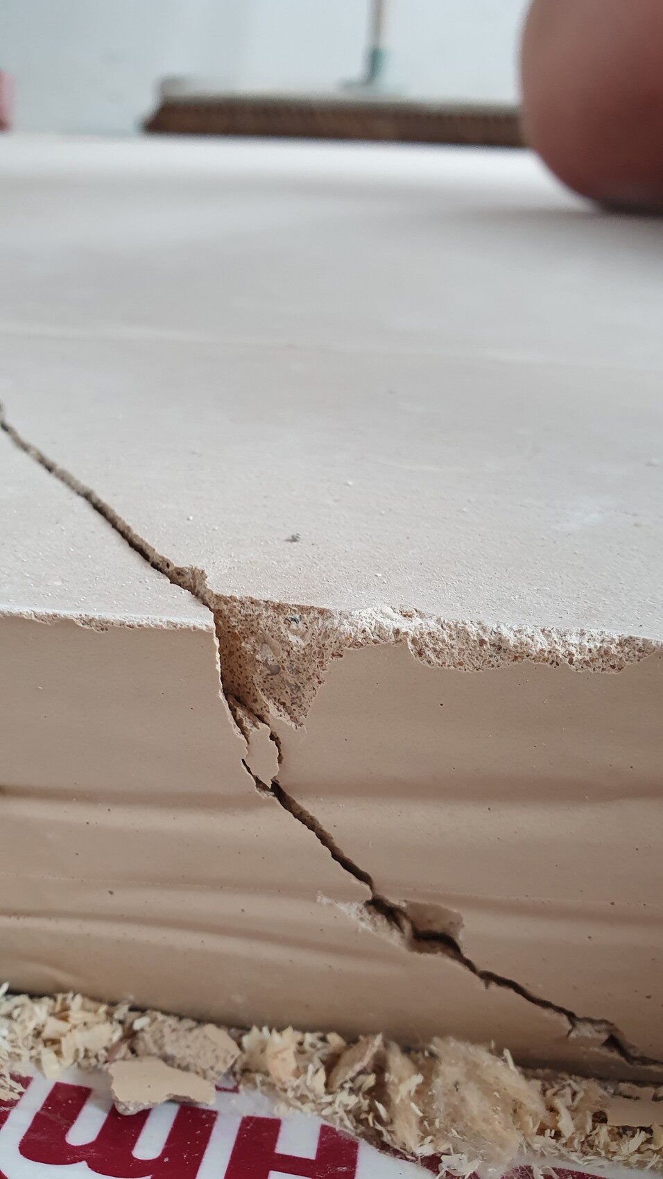

Hello Stefan,
Since the broken screed—as far as I can tell from the photos—relates to the edge area, it would be advisable to remove this section, prime the exposed screed edges, and reprofile them using a repair mortar.
If it is a calcium sulfate flowing screed, as I suspect, then when using a cement-based repair material, the edge priming should be done with an epoxy resin, followed by reprofiling “wet-on-wet.”
It’s an unpleasant situation, but nothing too serious!
A crack repair is certainly not advisable here.
Best regards, KlaRa
Best regards, KlaRa
Stefan2.846 Sep 2020 09:55Thank you for the feedback. It is indeed the edge area. I will mention this during tomorrow’s site inspection. Also, a simple patch repair is not sufficient for me. I have also sent this to the screed installer. He surely has an interest in ensuring that his work is of the best possible quality.
