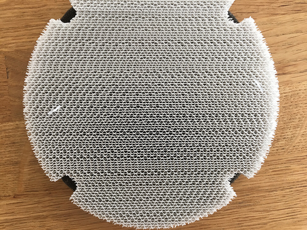

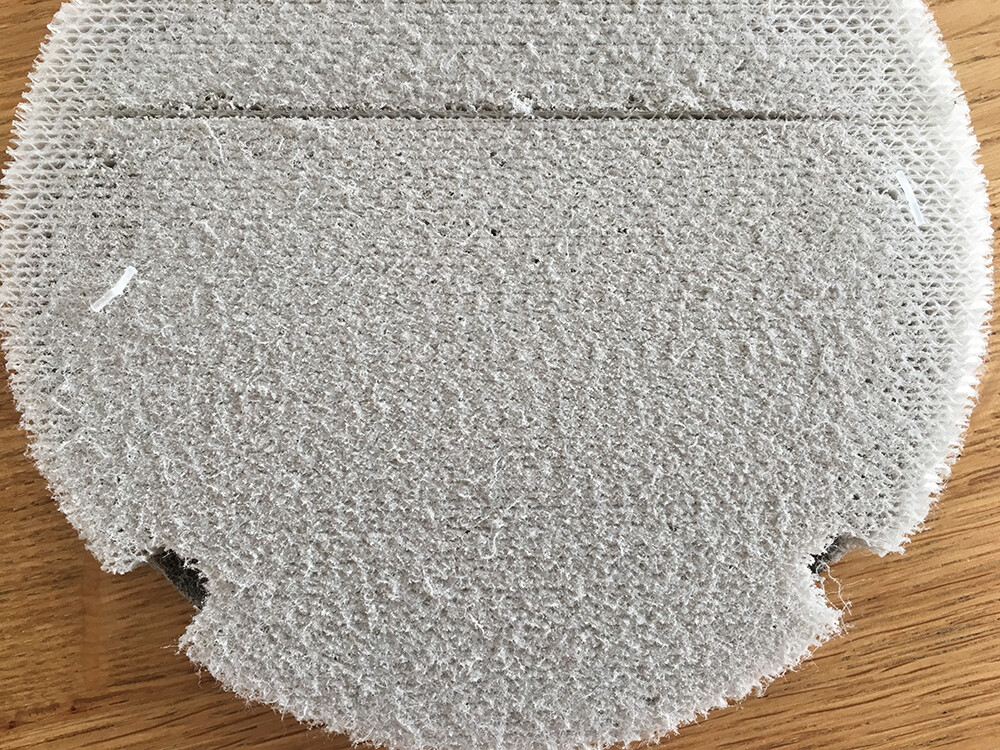

a quick follow-up. I wanted to show how important it is to clean the pollen filter regularly. In the attached pictures, you can see the interior side of the filter before and after cleaning. After almost a year, quite a lot of dust had accumulated.
Important: DO NOT rinse with water, ONLY use a vacuum cleaner. Otherwise, the surface will lose its effectiveness.
Regards
Balaturi
