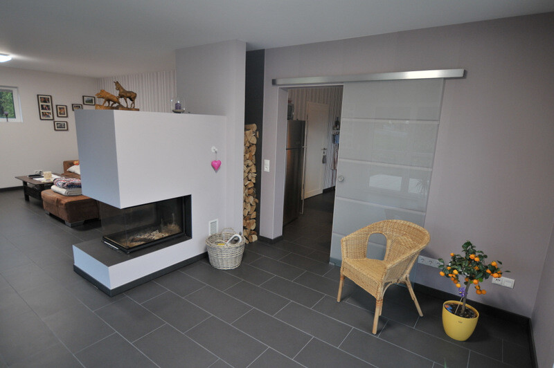

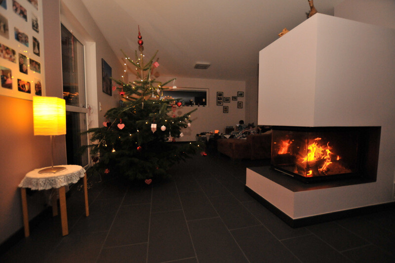

Here is another example from me. The total cost was about 1000€ above that of nordanney (excluding chimney, roofing sheet metal work, and steps). The insert used here is a Panorama 51/66/50/66 from Brunner. The chimney is not water-jacketed and doesn’t make financial sense with current wood prices anyway. So, it is purely for comfort and enjoyment. It was built by the chimney specialist using fireclay bricks, with a masonry back wall. Our tiler used our floor tiles for the tiling, and our painter and decorator did the plastering. We basically use it as a room divider in the living room, and it is currently burned about 3-4 times a week. The temperature increase is around 3-4°C (5-7°F) with moderate firing (starting temperature about 21-22°C (70-72°F)). We don’t have a pressure monitor. The stove installer recommended one, but the chimney sweep waived it. Fresh air supply comes through an air duct under the floor slab.
Cozy living room with decorated Christmas tree and burning stove.
Modern living area with stove, wicker chair, plant, and glass sliding door to the kitchen.

Here is another example from me as well. The price was about €1000 (approx. $1100) higher overall than that of nordanney
Your fireplace is wonderful! Absolutely fantastic!!! Respect. Best regards, Thorsten
