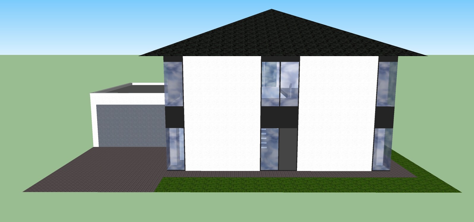

milkieWe are aware that there are quite a lot of windows. Our wish was to build a house with corner windows and middle windows, which unfortunately results in this number of windows.
The cloakroom next to the toilet is mainly intended for guests. We also imagine having another wardrobe in a kind of niche along the utility room wall. Perhaps even painted the same color as the wall, so the wardrobe is hardly noticeable!

P.S. Attached is a picture where you can roughly see our visual idea from the outside. (Referring to the window arrangement)
