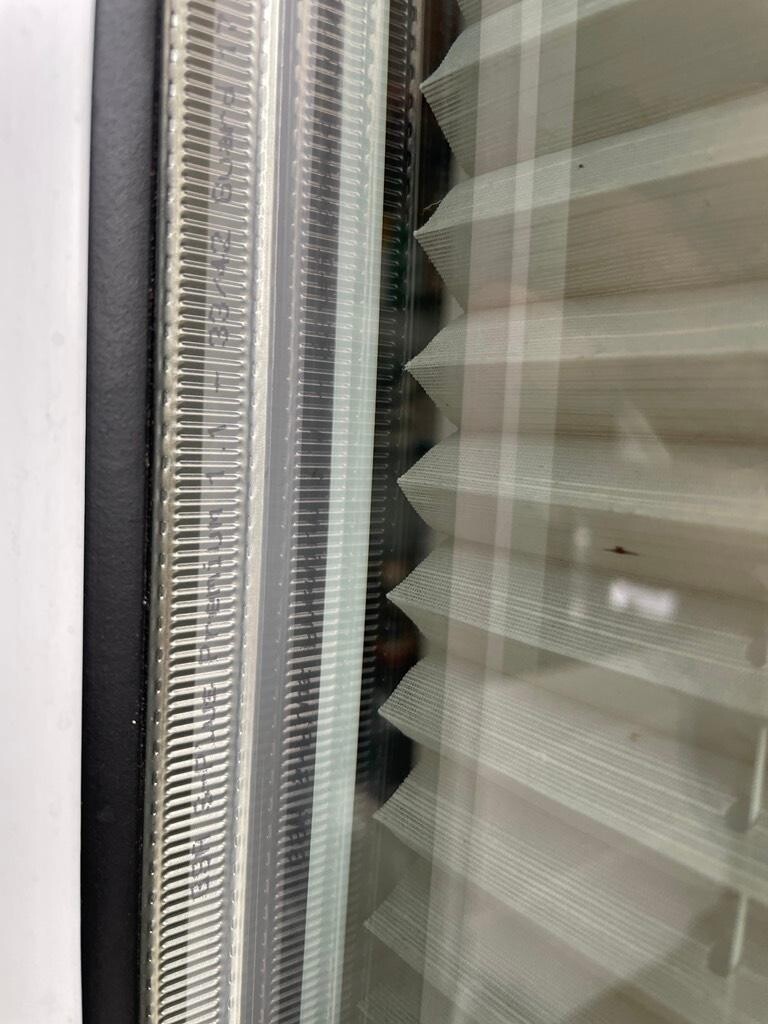

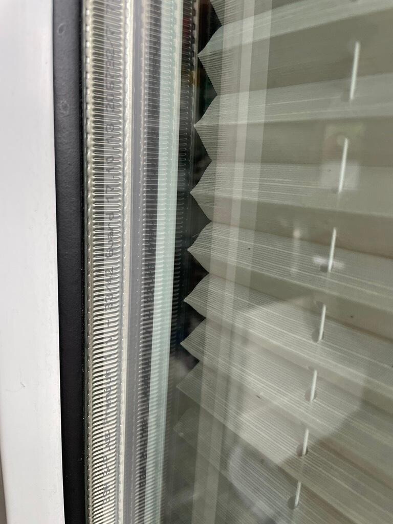

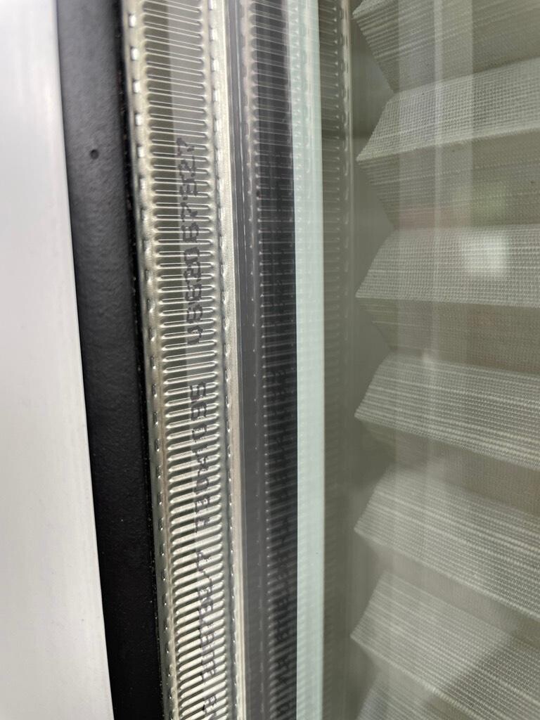

Hello, I hope someone can please help me determine if this window has sound insulation according to the marking on the frame. It would already help me if I knew the thickness of the window panes. I read it as:
Plus Premium 1.1 - 33/42 Guard 206722/7 720x1095
Thank you very much and best regards, Peter
Close-up of a window frame with glass, seal, and horizontal blinds behind.
Close-up of a window: on the right a white pleated blind, on the left metal frame.
Close-up of a window with horizontal interior blinds and seal on the frame
SaniererNRW123
17 Sep 2022 15:58
Jansepp schrieb:
33/42
These are usually soundproof windows. What kind of windows were installed?
