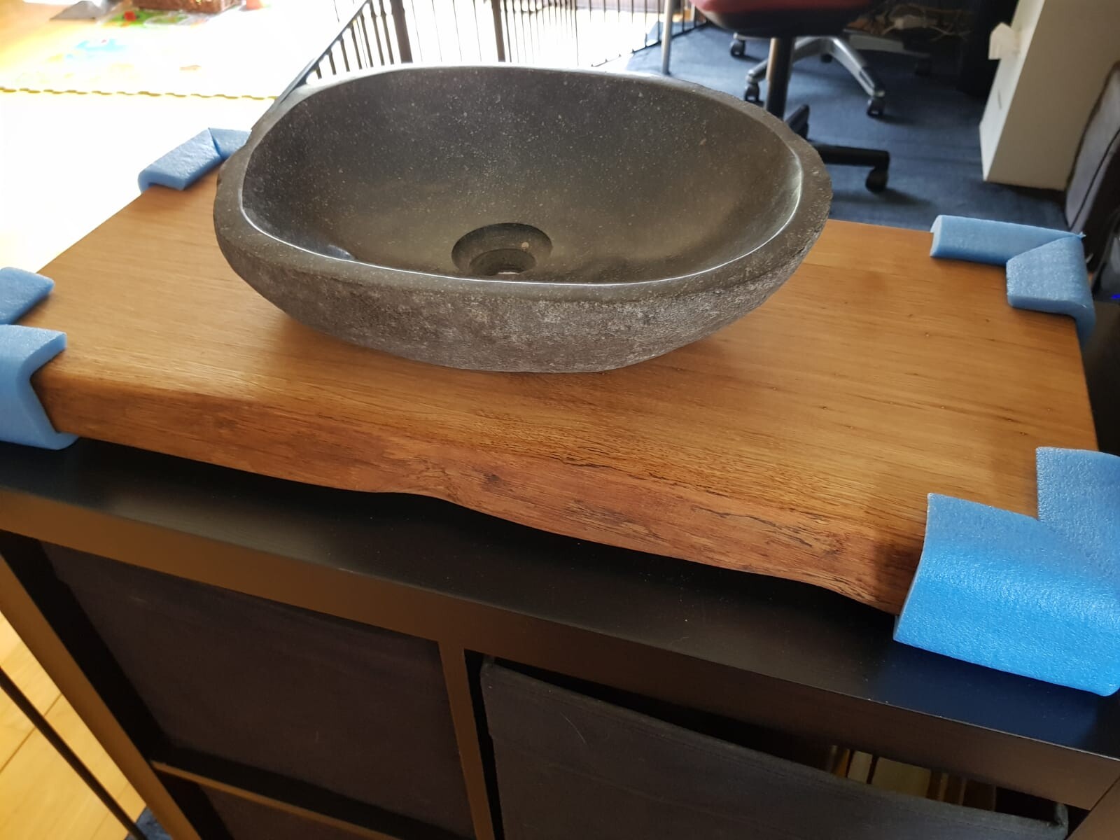

Today, our bathroom countertop finally arrived.
We plan to install a 30cm (12 inches) deep cabinet from IKEA underneath in dark brown (all for the guest bathroom).
I will order a suitable faucet from Reuters, a non-closing drain (in case it’s not included with the faucet), and a trap.
I think that should cover everything.
For tools, I have a Bosch rotary hammer, and I’m considering buying a 35mm (1⅜ inches) and 45mm (1¾ inches) hole saw—or whatever the correct term is for these cutting tools—just in case I can’t find someone to install and cut the holes for me (I would prefer if a professional does that).
Did I forget anything?

pagoni202030 Jun 2020 18:41Which Ikea cabinet are you planning to put underneath or hang? Wouldn't it look nicer if this shelf hung freely on the wall? There are brackets available where you can also hang a towel over the rail.
Alternatively, you could have something made with steel sled bases, which are really affordable and come in many varieties.
If the Ikea cabinet is narrower than the shelf, as far as I know, the top part is usually open.
Basically, you can also hang Ikea kitchen wall cabinets under the shelf, or use one or two Metod drawer cabinets, or the Godmorgen... in gray, which is very stylish and wide.
With this beautiful basin, you should check exactly which drain fits or ask the manufacturer.
