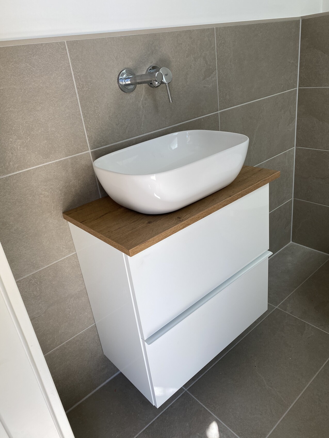

goalkeeper29 Jun 2020 09:36We had the same issue. The general contractor had nothing suitable in their range – we found what we needed at IKEA.
The washbasins are from Laufen, and the smaller one from Amazon, while the faucets are from Grohe – although only the expensive model included a pop-up drain.
We had the countertops custom-cut and specifically ordered them online for the washbasins.
pagoni202029 Jun 2020 10:08@goalkeeper
Super stylish and probably easy to make, nice pictures.
