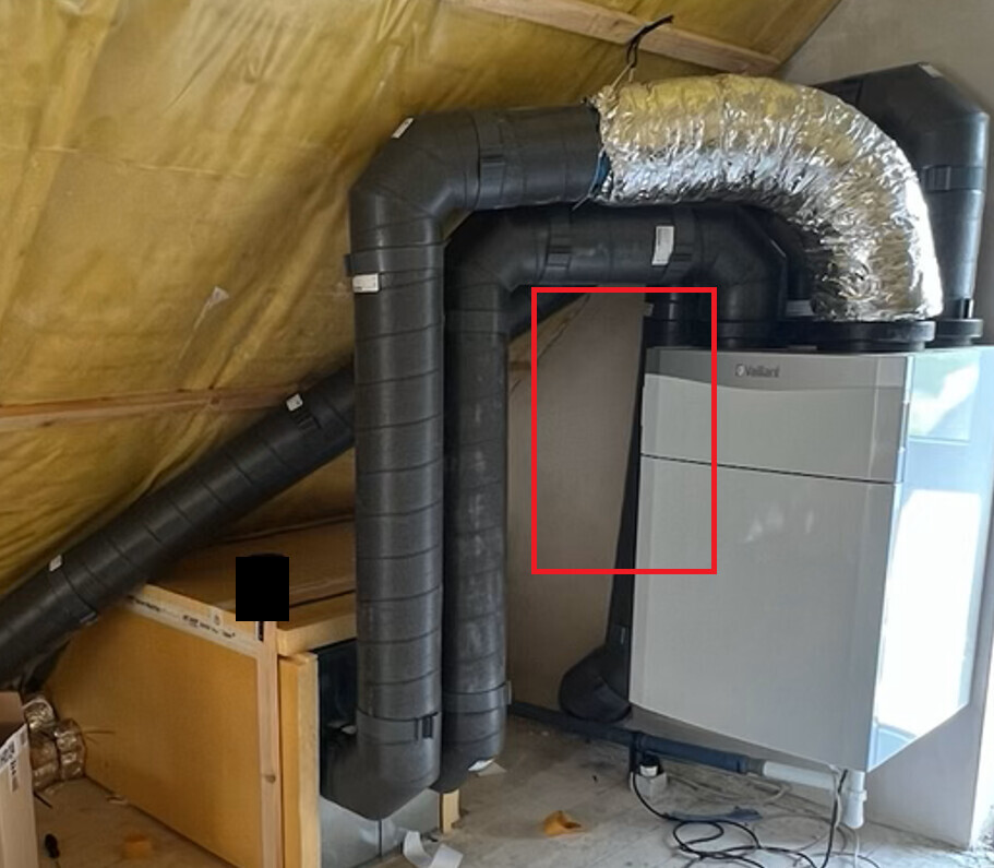

Everything has to be somehow squeezed in here:
Heating system in the attic: insulated air ducts, silver flexible ducting, and Vaillant boiler.

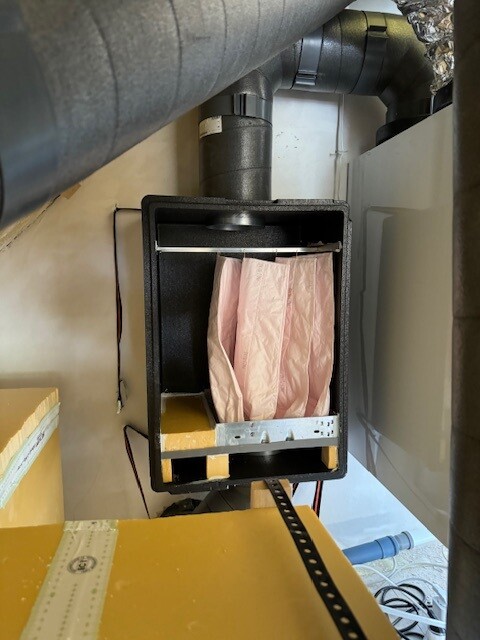

Hello, yes I have – it just took a while! There’s always something. In the meantime, the filter change indicator came on, which gave me some motivation after all.
It looks like this and has been installed since yesterday.
Compact building services unit with filter basket in ventilation system, visible ductwork.
I’ll gather my detailed photos and write a bit about the development process. But so far, it seems to be working and mostly airtight. At least I don’t feel any drafts.
So far, the system’s energy consumption is about 10% (3W) higher than before the modification. However, this is probably because the old clogged filter is still inside and I haven’t had time to remove it yet.

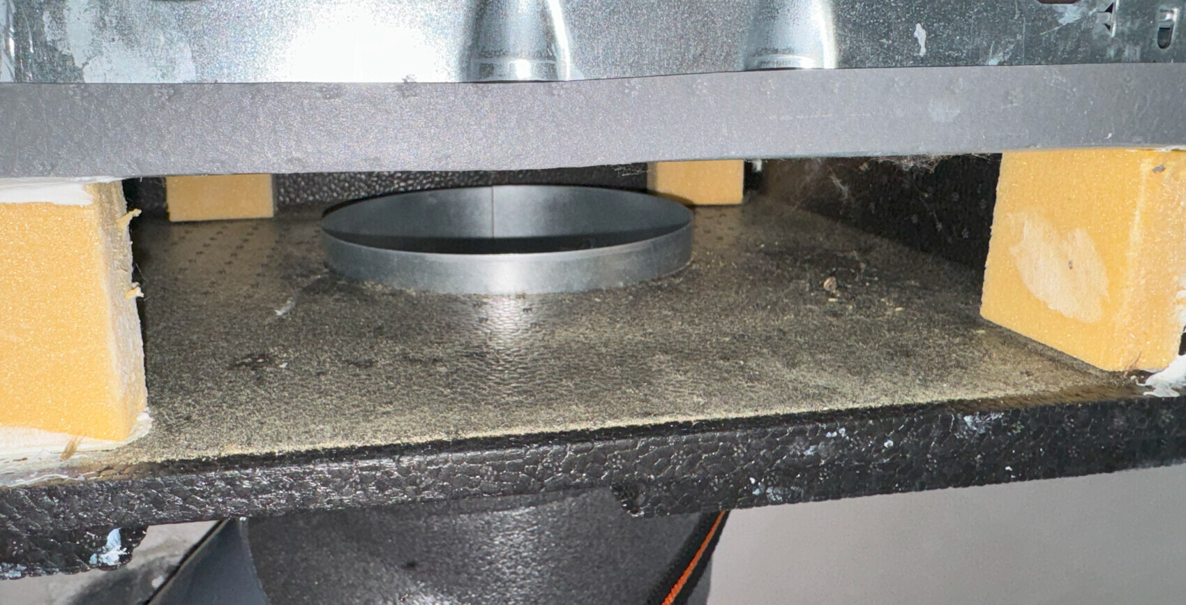

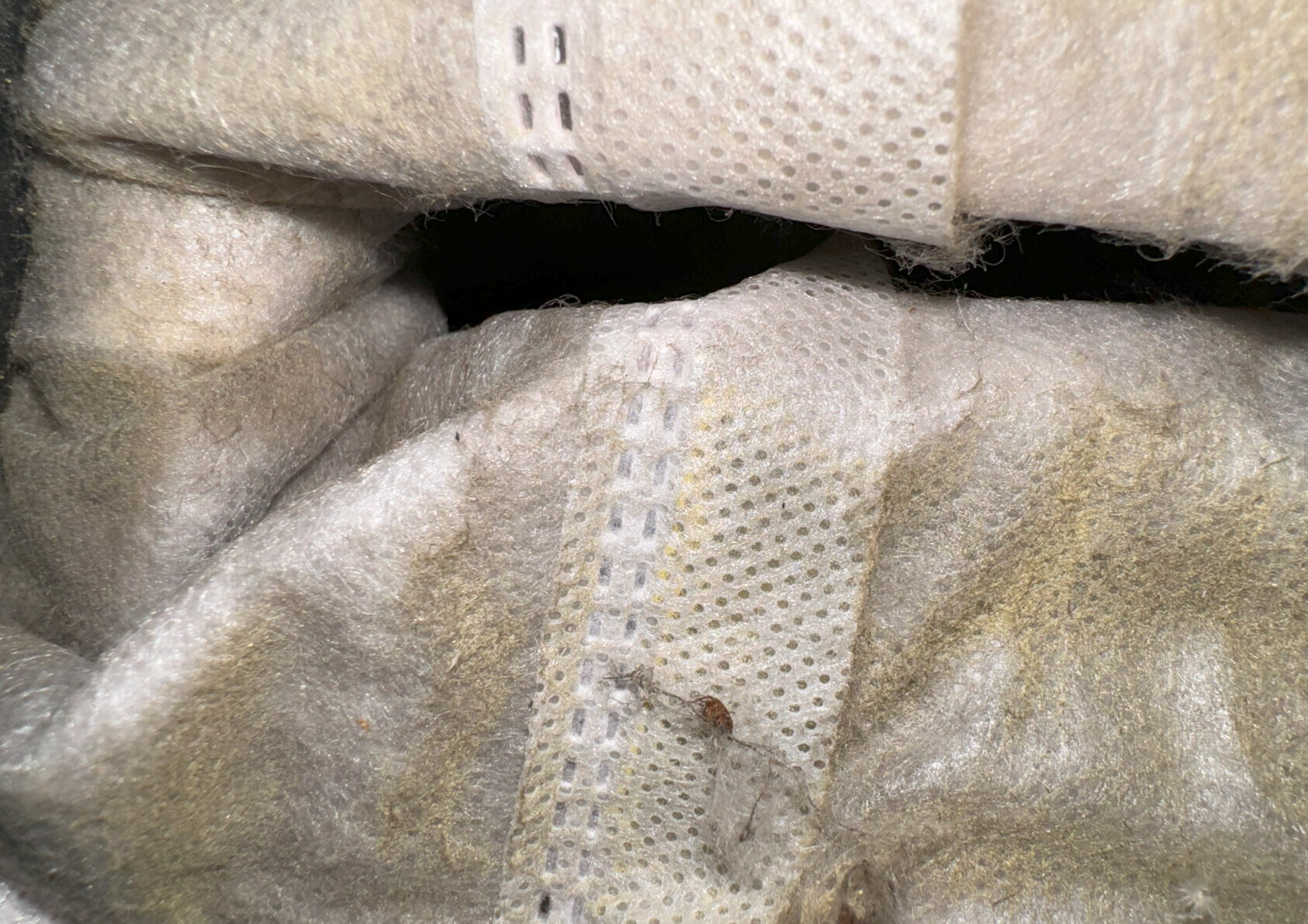

Today, for the first time in a long while, I cleaned the filters in the supply air (!) vents, and in the basement, I found quite a few dead flies. I clean the exhaust vents regularly, but I’ve been lazier when it comes to the supply air.
I immediately got worried that my filter setup might not be as effective as I thought.
However, upon inspection, I didn’t notice anything unusual. On the dirty side, there was quite a bit of dust buildup, and the filter was dirty. I also saw a few insects crawling on the dirty side.
Round metal ring rests on a rough black surface, framed by yellow-orange blocks.
Close-up of a dirty fabric with perforated tape; a small brown insect sits on it.
On the clean side, there were no deposits, dirt, or anything else to be found. So far, I’m very satisfied with my work. It really seems to be fairly airtight. The flies have probably been there for quite some time.
