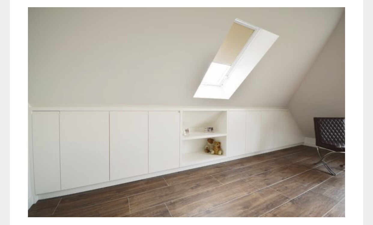

A local carpenter is really hardly any more expensiveIn my experience, you can save a lot of money this way, which is why I’m suggesting it. But yes, it only makes sense if you know what you want and spend more time on the planning.I would add a knee wall at the bottom edge of the skylight and box in the entire "peak" area. This space is basically useless anyway—you’d only bump your head there. I don’t see any cabinets fitting there either. It’s really only good for storing small items.
Once the knee wall is in place, the whole room feels much cozier, and the fear of the slanted ceiling is greatly reduced. I would also consider installing a dropped ceiling for the same reason.

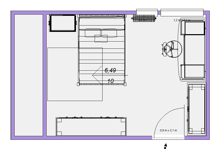

Most likely, I would arrange the bed like this:
Besides having easy access to the bed, this layout allows me to place a TV directly opposite it, so the teenagers can comfortably watch their favorite shows together in the 1.40m (4 ft 7 in) wide bed.

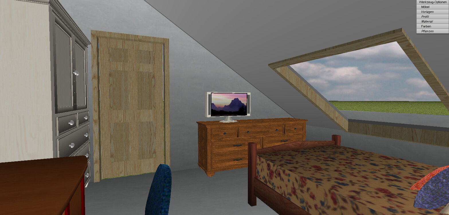

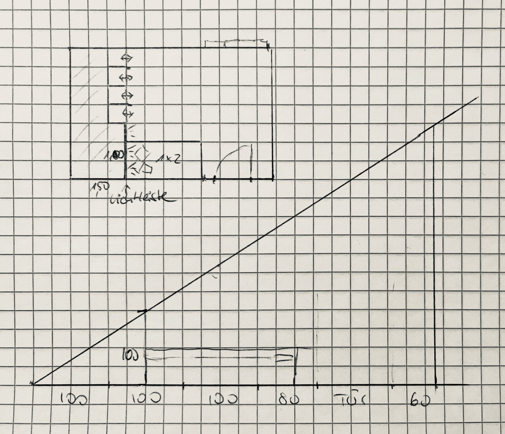

The space between the wall and the door frame is exactly 60 cm (24 inches). That’s why I would lean towards a wardrobe with a depth of 55 cm (22 inches)...?! For a child or teenager, even a depth of 50 cm (20 inches) is sufficient. We have that ourselves.
2linkehände2 schrieb:
Would you really prefer to place the bed directly against the door wall... wouldn’t it be better opposite? I would have it custom made by a carpenter. You can also work with sliding rails so that separated fronts can be pulled forward easily, where each front belongs to a triangular-shaped container.
I drew this once. The arrows show that you can slide four containers forward like drawers.
P.S. The drawing shows a 32-degree DN.

2linkehände23 Jan 2020 21:42From your drawing, I can’t really tell for sure myself (lack of expertise ) ...
If you place them just below the window... how high (at the front) and how deep (at the back) would these “pull-out cabinets” be?
