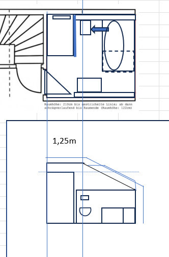

I am currently planning the shower enclosures for my two bathrooms. The bathroom in the attic has a ceiling height of 210cm (83 inches). I want to install a corner shower enclosure with a walk-in, floor-to-ceiling design.
What distance from the ceiling would you recommend? Can I install a shower enclosure that is 200cm (79 inches) tall, or would this cause issues with air circulation, meaning I should choose a lower height?
I look forward to hearing about your experiences! Thank you.

hanghaus202324 Oct 2024 14:54ypg schrieb:
The front edge of a toilet should be at least 2 meters (6 feet 7 inches) high. Maybe the roof window could help here?I have moved the toilet exactly up to that point. It can be shifted a little further to the left as well. The roof window doesn’t help here; it is too far away.It should definitely be possible if you really want, even with a bathtub.
weebi471124 Oct 2024 15:13Thank you all for the feedback! I will try to address the toilet issue as well. The shower enclosure definitely should not be 200cm (79 inches) high, but instead "only" 180cm (71 inches) or would 190cm (75 inches) also be acceptable?
