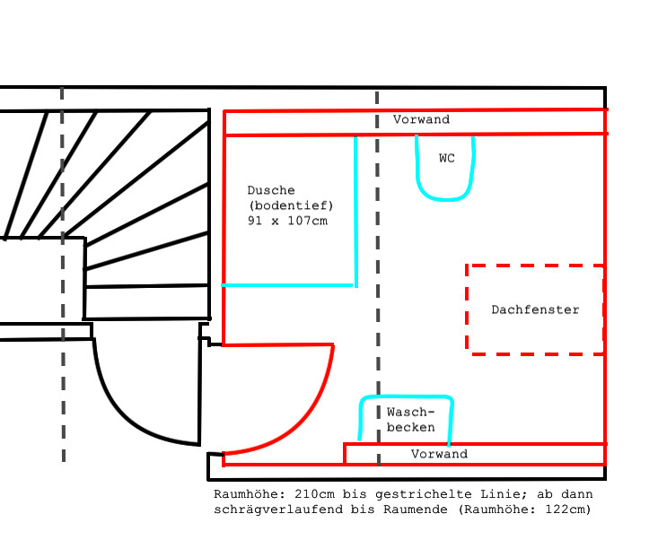

weebi471124 Oct 2024 10:57Thank you for your feedback! Here are some details about the bathroom:
- This is an additional bathroom in the attic of our semi-detached house, which was optional. We decided to include it.
- There is a skylight for room ventilation.
- Up to the dashed line, the room height is 210cm (83 inches). Beyond that, the ceiling slopes down to about 120cm (47 inches) at the end of the skylight.
To help visualize better, I have attached a sketch of the room layout. I hope this makes the planning clearer.
Thank you all!

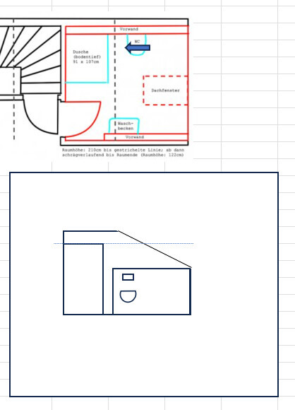

hanghaus202324 Oct 2024 11:25Here is how I understand your information.
I drew a line at 1.8 meters (5 feet 11 inches). The toilet should be moved slightly to the left. Currently, there is only 1.8 meters (5 feet 11 inches) of standing height there. Otherwise, you will need the sign.
I would suggest the shower enclosure be only 1.8 meters (5 feet 11 inches) high.
